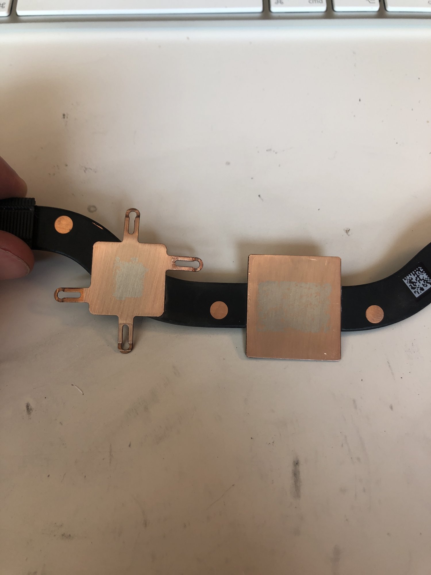

I removed my “liquid” metal and replaced it with some kryonaut :) Cinebench R20 scores went up by almost 200 points! The “liquid” metal had solidified completely and fused itself to the heatsink... I sanded it all down with some fine sand paper, applied the Kryonaut and voila!

Yeah, when I applied it all that time ago, it was something “new” and everyone loved it. But since there was no real “long term test”, I assumed it was all fine, especially since they claimed it would last for up to 5 years...
What state was the processor in - I've seen servers type E5-2690 with the metal casing completely melted by it.
Luckily it was fine, the liquid metal was sort of fused to it, but with a little scrubbing with some cotton sticks and alcohol I got it all off the CPU dye, though the GPU dye was a bit more stubborn and I couldn’t get it perfect. Since it was ok and didn’t want to sand it down as well I left it as it was. No more liquid metal for me though.
I think that's a lesson to everybody who wants to give it a try - stay away from it unless you're happy to replace the CPU and associated accessories when you replace the thermal paste.
You're fortunate that the CPU wasn't damaged.
