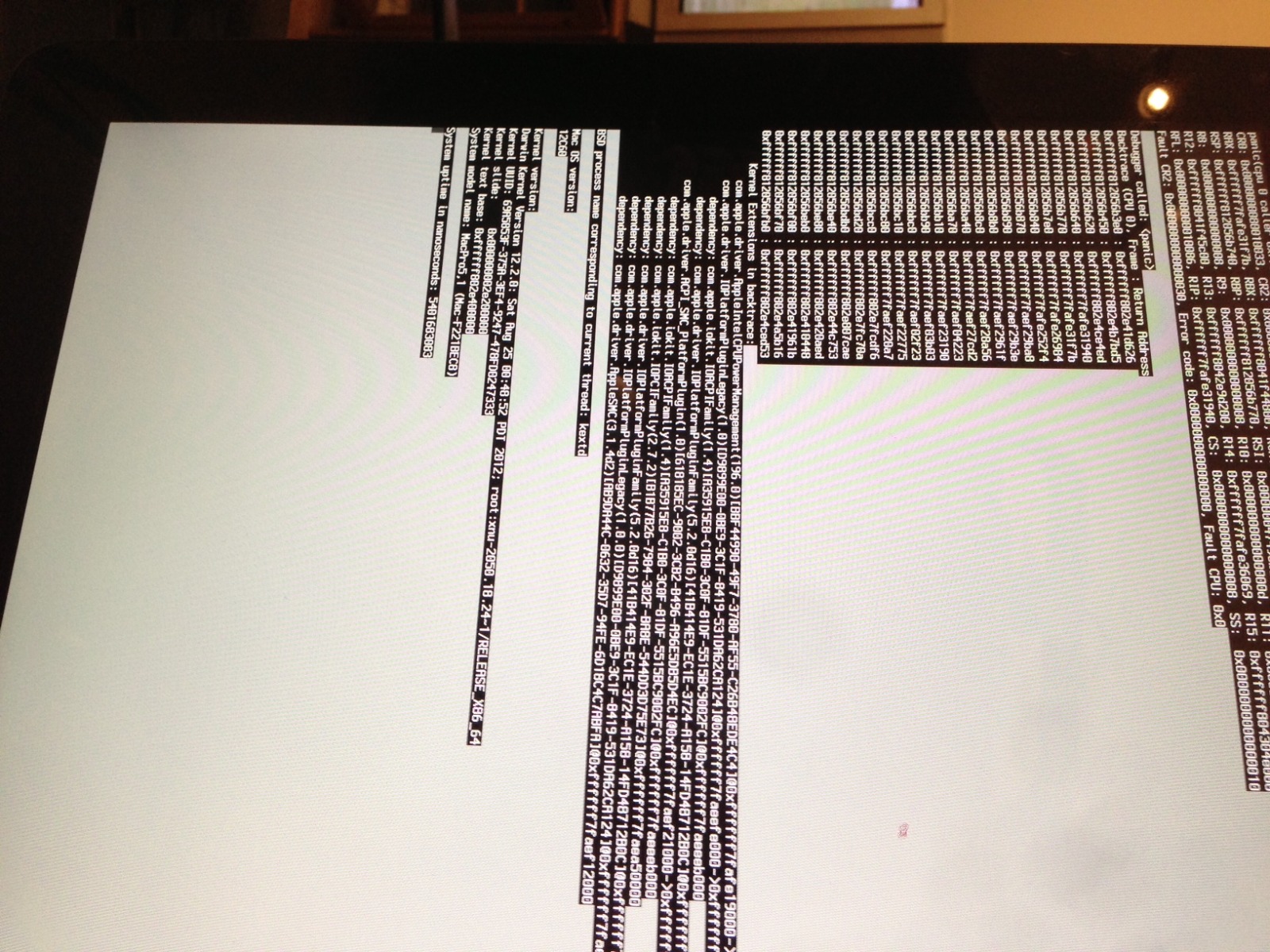

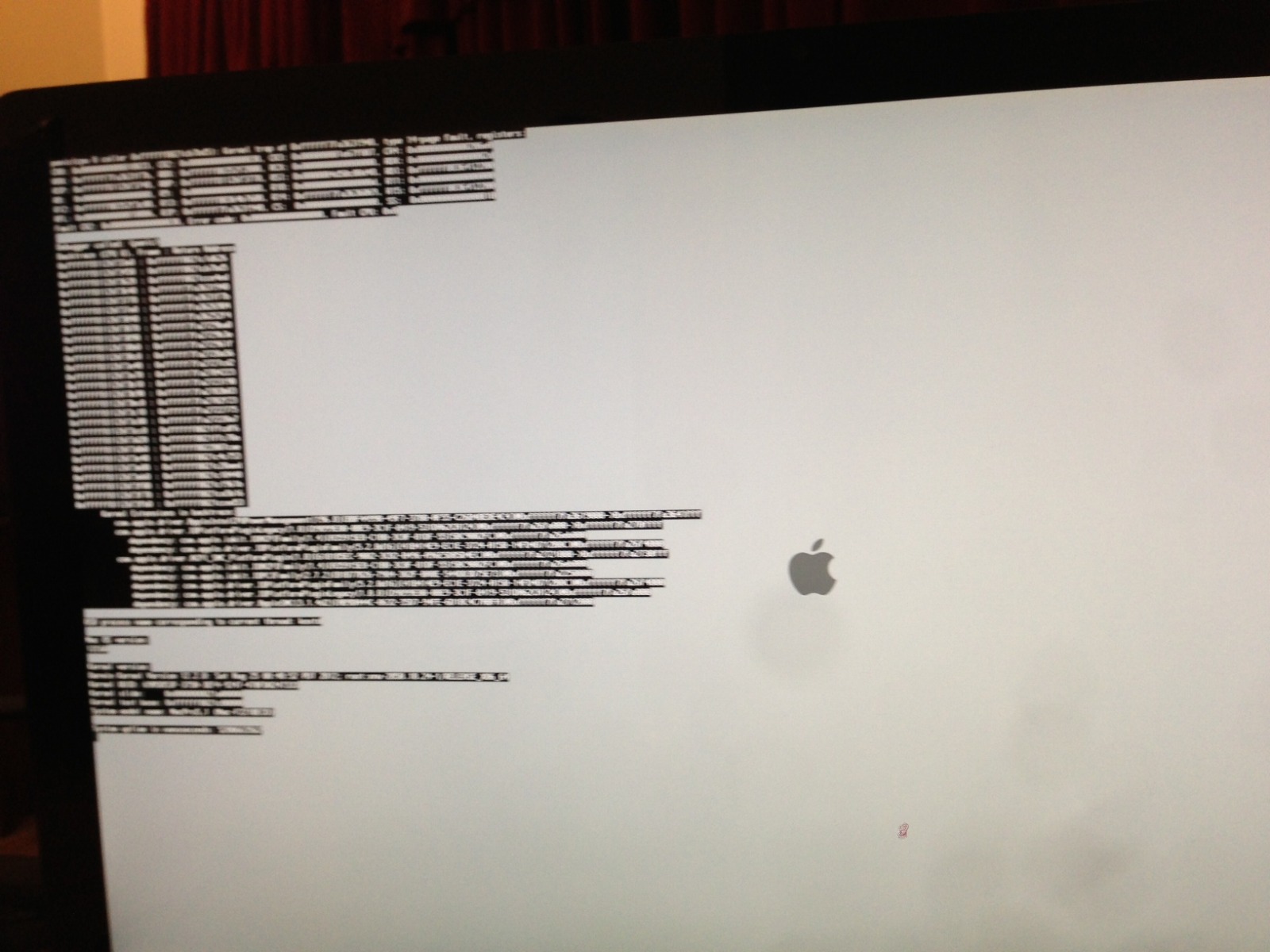

K So I got over my laziness and decided to Swap CPU A and CPU B and see what happens. Counted 3.5 turns to get the heat sink down right. Fans still spin on heat sink when I start up now I get the boing, both heatsinks' fans spin up like expected.
But I get this when booting
and then it restarts the boot up process and I get this screen
Says something with kernel and goes before I can really read it.
before repeating in an endless loop. Some help trouble shooting would be great.
Thanks in advance apprciate any help I can get

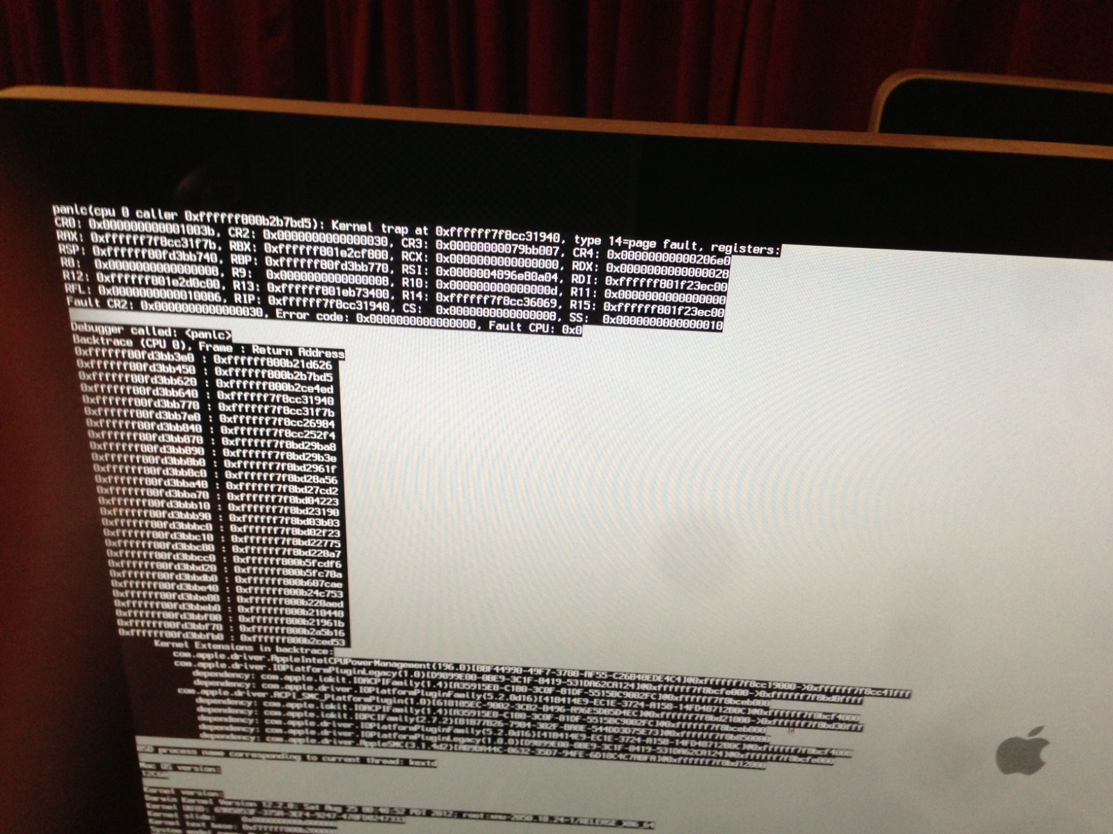

Got a ledgible shot of the screen
Btw how do I make these images thumbnails on the forum?
Can anyone please help me out with this ?
Thx again
Here's a shot including the text at the top of the screen
I assume thet you've done firmware update to 5,1, otherwise your MP shouldn't even POST with hex CPUs.
Check this out first and try: https://forums.macrumors.com/posts/11692308/
Try also diagnostic LEDs on logic board. It might be also worth to try this "not booting" CPU alone in socket A. If it won't change anything, that means this CPU is damaged.

Upgraded to 5,1 already and when I had the other CPU in CPU A the Pro booted up with it recognized and worked at that point just fine.
No diagnostic LED's turn on when I have the comp on and doing this endless repeating cycle. I did have CPU B Fail (I Believe light from behind CPU B heat sink) when I had the CPU I switched into CPU A there. But that didnt come on all the time it only came on when I tightened it to a comparable level to heat sink A.
Thanks for the reply guess I'll be requesting a replacement CPU out of my seller then.
...I'll be requesting a replacement CPU out of my seller then.
If the weird screenshots happened when you swapped CPU A and B, then they seemed to confirm that you have a defective CPU on hand and it did not work in both CPU sockets. The chance of getting a bad one usually is very low. Install the good one back to CPU A socket and make sure it still works properly, then return the bad one and wait for the replacement. Maybe go try your luck with the lottery while waiting.
Yea the weird screenshots happened with Problem CPU in Socket A
Reverted to my older CPU's for now having no issues whatsoever so guess that basically confirms it. Hopefully replacements will arrive quickly and not have any such issues.

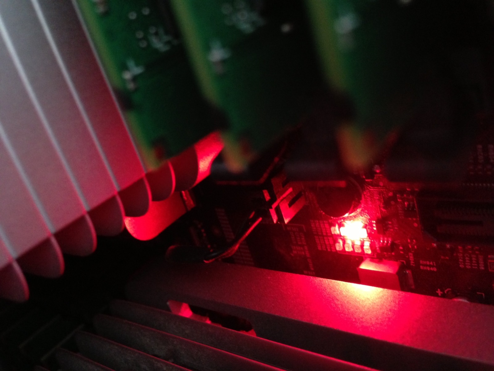

Hey everyone if I could get some help on this it would be great.
Got replacement CPU's yesterday installed them and all works except the 2nd Memory Channel attempting to loosen and tighten not really having a great effect on the issue.
Could someone give me some pointers on how to get this resolved....
Also is it dangerous to run the computer while one memory Channel isnt being recognized and the red light is lit on the processor board
Thanks in advance everyone.
Boots up fine just doesnt recognize this 2nd Channel of memory so it sees 14GB vs 16 GB
This is due to uneven pressure on the processor. So you need to make sure the same pressure of the four screws. It also happened to me in my upgrade. Just loosen the screws and tighten them in diagonal order until the same tightness level is achieved.
I tried doing this several times didnt work for me. But then got the courage to tighten it past where I felt it was safe by 1/8th turns and finally got it recognized. Was a bit afraid of over tightening it though even though I had the 3 washers on each post.
Can someone tell me what temperatures I should be expecting at idle and under load so I can be confident everythings working correctly. Thanks
