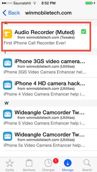

UPDATE (Jan/04/2014 10:27 GMT): I've cleaned up and streamlined my Cydia repo so that you can quickly find the version you'll need (AT&T vs. rest; iPhone 5 vs. 5s). NOTE: trying to install the wrong version is safe as the installation will simply fail.

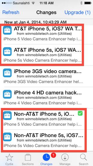

In the screenshot below, I've annotated the two times two tweaks:
UPDATE (Jan/04/2014 08:17 GMT): iPhone 5 + AT&T version (the one with the N41 directory) out: https://dl.dropboxusercontent.com/u...5videocameraenhancer7att_1.0_iphoneos-arm.deb (see THIS).
