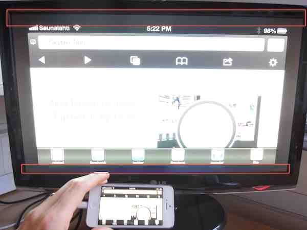

In this case, the iPhone's screen is mirrored using a decidedly lower resolution than it otherwise would be possible with a Full HD monitor. The latter is pretty much the norm nowadays – at least when it comes to LCD monitors. (Most projectors still have lower native resolution.) This results in the thick black bars in the mirrored picture. I've even annotated the lower and the upper ones in a slightly edited version of the above shot:
Note that I dialed in strong exposure correction in the camera to make the active area of the screen in black still much brighter than the bezel so that the unused screen area can easily be spotted. This is why the center, white area of the screen is pretty much over-exposed.
Unfortunately, the case with the previous small-screened iDevices and the iPads are the same. The former have a screen with the aspect ratio of 3:2, the latter with 4:3. This means noone would expect their mirrored screen to entirely fill the screen of an external monitor. An example of the iPad 3's screen being mirrored over a wired connection (a VGA adapter):
As you can see, as opposed to the iPhone 5 / iPod touch 5 case, the full vertical screen estate is utilized. There, however, remain black bars on the left and right.

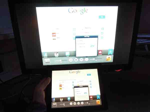

As most Flash Web browsers don't natively support TV output, using the, in 2011+ models, native mirroring capabilities is the only way to show their output on an external screen. However, this, unfortunately, means in no way will be the entire screen estate used in any case – there'll always be black bars on both the top/bottom and left/right with small-screen devices and on the left/right with iPads, both when used in Landscape.

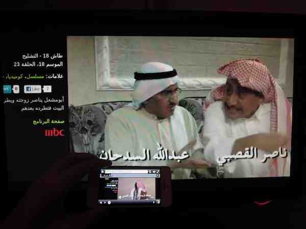

The only exception is the Photon Flash browser (AppStore links: iPhone / iPod touch version ($3.99); iPad version ($4.99)), which has native support for video output.
This means it does make use of the entire screen area on all kinds of iDevices with screen aspect ratios from 4:3 through 3:2 to the Full HD-native 16:9.
This also means it'll stretch the screen of non-natively 16:9 (that is, 3:2 and 4:3) devices. This is why the following iPad 1 shot shows a somewhat distorted (horizontally stretched) image:
Now, compare it to the following iPhone 5 shot, where the native 16:9 screen aspect ratio is retained (no horizontal stretching needed to be made):

No matter what HDMI / VGA / AirPlay-capable model (including the 2010 models) you run Photon on, make absolutely sure you enable full screen mode when playing back videos by tapping the arrow icon in the upper right corner. Otherwise, the active content will be badly cropped. An iPhone 5 shot of this:
(Note that, because of the restrictions when not playing back iOS-native video files, this shot also shows black bars around all the edges – as with the previous one showing Photon running in the recommended full screen mode on the iPhone 5.)

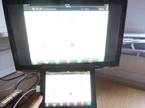

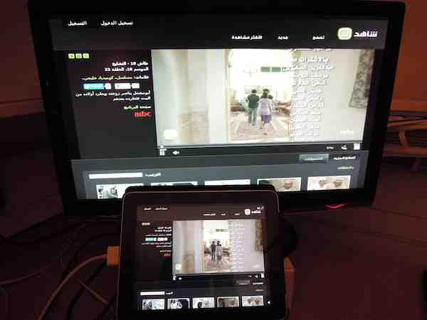

An iPad 1 one:
And, finally, an iPod touch 4 one:
Note that the cropping problem is the worst on the last shot, a lot of the video's active area not being shown on the external screen. No such cropping would happen with enabled full screen mode. Also note that, as opposed to the iPhone 5 case, the full screen estate is used - as would be the case in the recommended full screen mode too.
Also note that, while both the iPad 1 and iPod touch 4 (iPt4 for short) belong to the group of iDevices released in 2010, explicit TV output from inside Photon has exactly the same problems as with 2011+ iDevices. This is why I've discussed them here and not in Chapter 2.

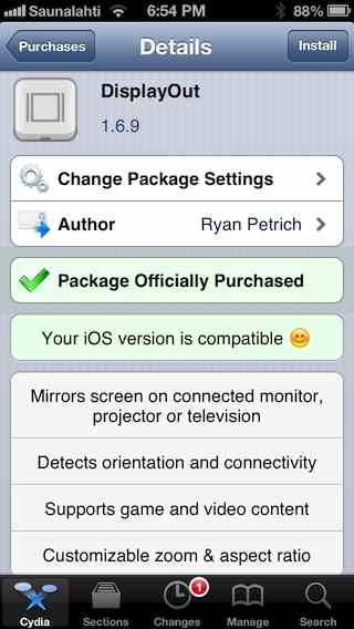

2.1 DisplayOut
DisplayOut (Cydia store description link; $3.99) has become an excellent app capable of screen mirroring speeds that come pretty close to Apple's own mirroring during the time.
(The main Cydia Purchases page with DisplayOut, shown on my iPhone 5.)

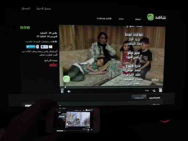

First, I quickly show the Settings interface of DisplayOut, and, at 0:22, start the Flash video browser SkyFire. (Which, again, doesn't explicitly support TV out and, therefore, cannot be used on any pre-2011 iDevice to play back Flash videos). After a lengthy loading process, the video playback starts at around 1:40. As you can see, the mirrored screen isn't cropped and fills the entire screen estate (by introducing horizontal sctretching – after all, the iPt4 has a screen of 3:2 aspect ratio) and is pretty fast – almost as fast as the playback on the iPt4's screen.
(Incidentally, as has been explained in my previous article, back on 06/22/2012, SkyFire entirely failed to recognize the test video at http://shahid.mbc.net/Media/video/23043 . Newer versions play it back just fine, as you can also see in my video. Also note that, back then, Photon delivered the worst performance with this demo video and Puffin was significantly faster. Now, Photon was noticeably faster.)
At 2:26, I switch to another Flash browser, Puffin, which doesn't explicitly support TV out either. The playback on the iPt4 screen (and, of course, the mirrored external screen) is way slower than with SkyFire – or, as we'll soon see, with Photon.
At 3:20, I switch to Photon. After the original page is loaded, at 3:47, I tap the thunder icon in the lower right corner so that the browser switches to proxy-based streaming mode including Flash. At 4:00, DisplayOut states Photon (as we already know) explicitly supports TV out and that it's recommended to switch off DisplayOut altogether for better performance. However, in this case, I just stick with DisplayOut to show what it's capable of and, therefore, continue playback, which starts at around 4:20 and shows much better performance than that of Puffin – but still somewhat worse than that of SkyFire. As the video playback framerate doesn't really exceed 10-15 fps in this case either, there isn't visible difference between the framerate of the video rendered on the iPt4G's screen and on the external TV. That is, the performance hit introduced by using DisplayOut's explicit mirroring as opposed to Photon's own TV output isn't really evident.
