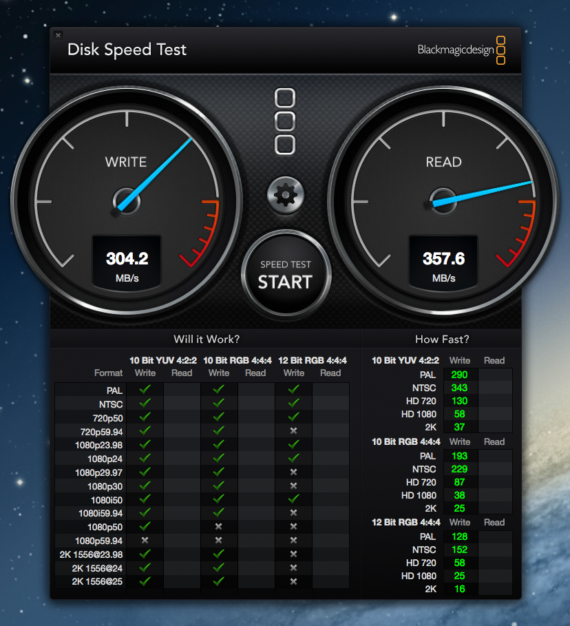

My recollection is that I did move it around to different slots, but was not able to find a combination that worked for me. It's entirely possible that I failed to get the right placements, but after fighting with it for a while, I decided just to get the X1. I have not noticed a difference in performance for typical use, so I'm happy with where I am. Plus, it was a lot cheaper. Keep in mind I'm running the 830, and not the 840, so the X1 provides enough bandwidth for most uses anyway.
Edit: I just tested the drive with Blackmagic Disk Speed Test, and I reliably get around 300MB/s+
