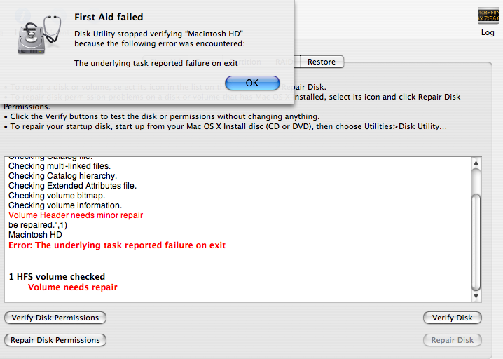

Anybody seen this before. I've tried repairing permissions and then repairing disk but get this message.
Actually, it's:
1) restart
2) try Repair Permissions
And if the above fails, try:
3) boot off install disk and run disk utility to "Repair Disk"
4) boot system from hard drive
5) Repair Permissions

i was going to say boot in single user mode and do a fsck, but your way is easier.
i have never seen that before but it doesnt sound too good! hope your hard drive isnt about to go ping
I had the same and repairing the disk using the OSX CD fixed it with no problems since. Hopefully you'll fix it just as easily. 🙂

benthad pointed me to this thread, and i followed the steps and it worked for me in regards to repairing my disk, however when i repair permissions i have quite a long list 🙁
btw, i ran applejack before i found this thread and it did not repair the disk. doesnt applejack just run fsck, which is basically what the osx cd does?

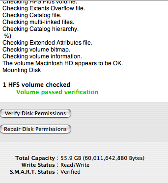

If you are able to, never use the disk utility from a Tiger DVD <10.4.3. The Disk Utility tool was updated in 10.4.3, and when booting of the DVD you will use the old version.
Instead, boot in safe mode: cmd+s and run fsck, if possible. Besides, do not trust the result you are getting from live disk verify. Early reports indicate that they can be giving false results...
Disk utility has the ability to "freeze" the system when performing live verify disk. fsck will not, hence can report false errors on the filesystem.
True, but only for the disk permissions. You can repair the actual disk (as well as any app possibly can) using the disk. 🙂
Good points by Loke, but since there are no 10.4.3 DVD's (well mine is 10.4.0) I really didn't have a choice! It does seem like the verify disk running from the HD is reporting some invalid errors. After running Disk Utility from the CD all of my problems were "repaired" but, after rebooting, i checked Disk Utility again, and it says that things were not repaired. Well, my system is running fine, just remind me to shoot myself if i ever decide to become an early adopter of an os update in the future!😛
