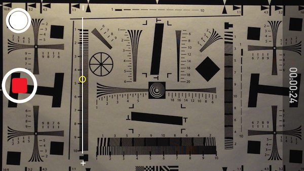

As has already been mentioned, the built-in zoom slider in the stock Camera client, in both iOS7b1 and b2, fails to make use of the extra pixels to deliver lossless zoom.
While creating a test video footage, I've set a value on the zoom slider close (but not higher than) to the above-mentioned maximum, that is, 1.454545x (note the slider at the bottom of the screen - in Portrait orientation):
(as with all the other images in this article, click the image for the full-sized, full-quality, original version!)

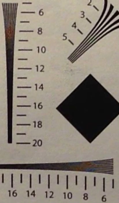

With the above setting, the reschart result is as follows:
The point where the lines are no longer distinguishable is around the 8 mark. Beyod that, there's absolutely no detail. (For comparison: without zooming, it's at 10.8 corresponding to 1080 pixel rows).

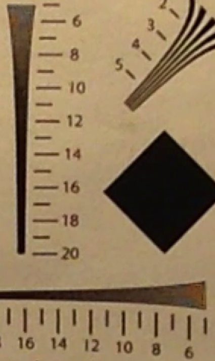

As expected, it has very bad resulution at the maximal (3x) zoom:
The point where the parallel lines are no longer distinguishable can't even be seen in this crop - here, marks start at 5.5. By scrutinizing the full, original image (again, click the thumbnail to get it!), you can easily see it's around the 5 mark.

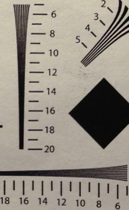

Finally, at the default 1x zoom, the results are, as has always been the case with all iPhone and iPad models manufactured after 2009, excellent and indeed makes almost full use of the resolution capabilities of the output file:

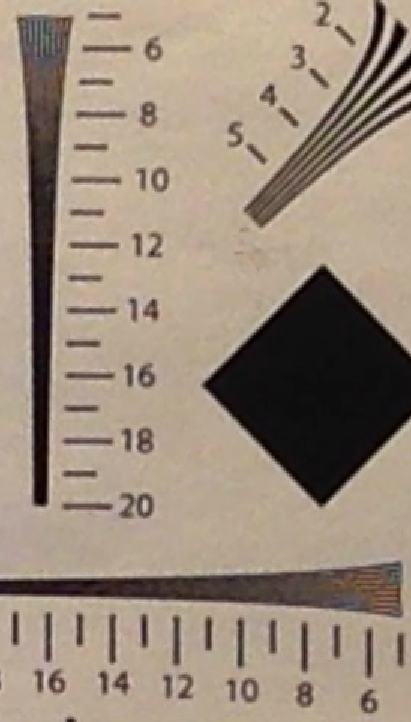

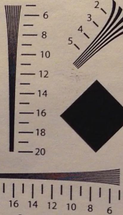

1.454545x zoom (that is, the theoretical maximum of lossless zoom range):
3x zoom:
As you can see (make sure you compare the results to those of the stock Camera app in Section 2 above!), both are immensely better than those of the stock Camera app. Actually, the 1.4x zoom is only a little bit worse than the 1x one (see the last shot in Section 2), in which it's comparable to the pretty little quality loss on the Nokia PureView 808 when zoomed in to 4x on it (again, see the GSM Arena review's comparison).
