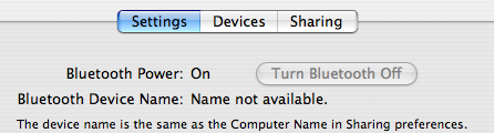

OK, so this is more of a niggle than a real problem but it's curious. Basically I no longer have the ability to turn Bluetooth off on my iBook, in the menu or in system prefs (see attached screenshots). I'm using a D-Link DBT-120 adapter so it's not a big deal (I can just unplug the thing!) Have repaired permissions, restarted, and it wasn't a problem after installing 10.4.3 - this has just developed in the last few days. Any thoughts?

that particular device probably doesn't let you turn it off. that's why.

Nope - I've had this adapter for over a year and have been happily turning it on and off until a few days ago...

did you have a device connected when you were able to turn it off before? perhaps? just taking a random guess here....
Try spotlighting and deleting the plist associated with it... probably "com.apple.bluetooth.plist" but maybe something else, since you have a 3rd-party adapter. You can move it to the desktop while the device is NOT inserted, and then plug the device in, just to make sure you don't lose anything valuable. You might have to re-pair devices.
Funny, the same thing happened to my Mac (10.4.3). I had to go into the Bluetooth File Exchange utility to turn Bluetooth back on. Once I did that, I could turn the bluetooth adapter off and on normally.
This is with a built in adapter.
Aha, that fixed it - thanks!

I have the same problem right now. I just noticed it when I tried to connect my Apple Wireless Mouse to my iBook (10.4.3, built-in adaptor). I couldn't connect my mouse to the iBook, so I wanted to try to turn bluetooth off and back on again, to find that I can't turn it off! I tried deleting the plist files and it didn't work. I also tried the bluetooth file exchange with no luck 🙁
Any suggestions?
EDIT: I got it working again, it seems there's some kind of glitch in 10.4.3
Wow, very weird. I saw this thread recently and didn't pay much attention. Now I too have the same problem on 10.4.3. Not sure what to do. BTW, I have bluetooth built in to my PowerBook, but have yet to use it and I don't have an ext. adapter.
Yup, restart did the trick. Seemed to start randomly though, not after an update😕
EDIT: Ha! I was able to recreate the problem! Seems to happen after I try the Safe Sleep (hibernation) hack on my powerbook. Link To Safe Sleep Hack
