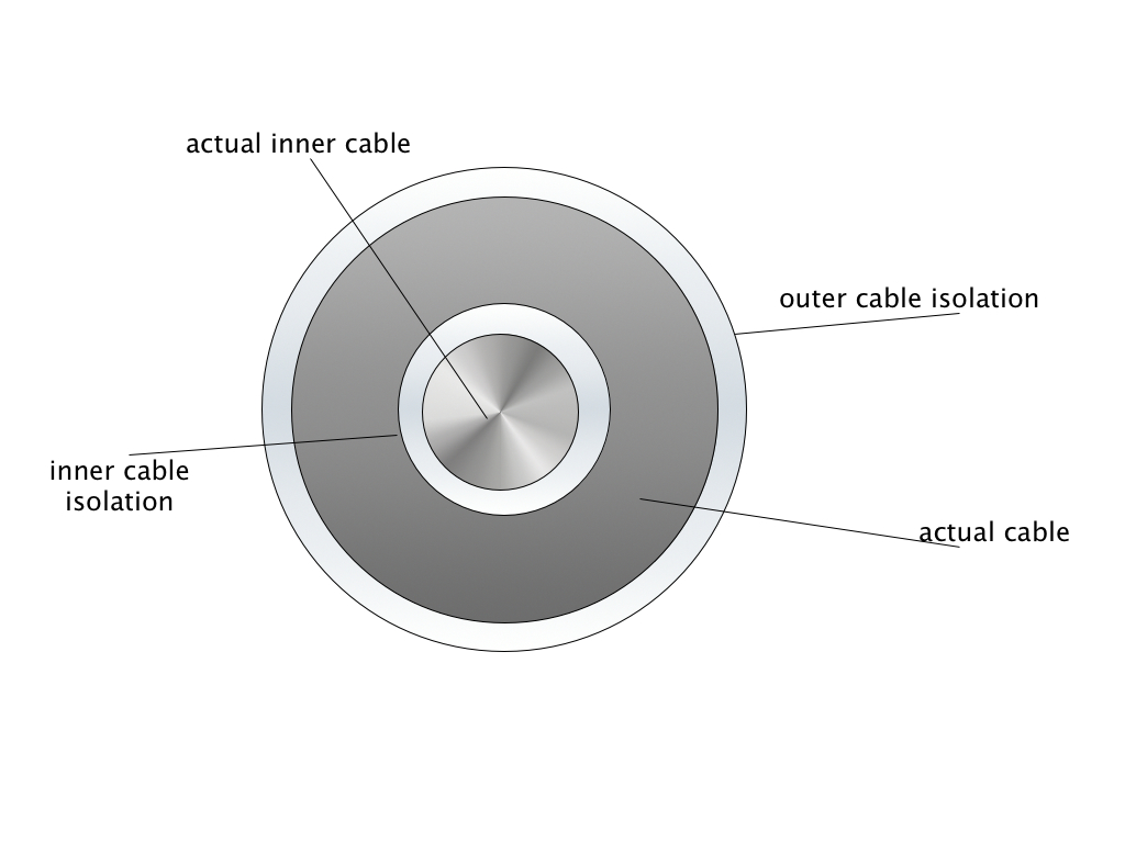

The problem is, that it seems, that Apple decided to put huge amounts of glue inside. So I was looking for another solution. To find another, one first has to find the real problem. Why fix the connector, if only the cable is broken?!

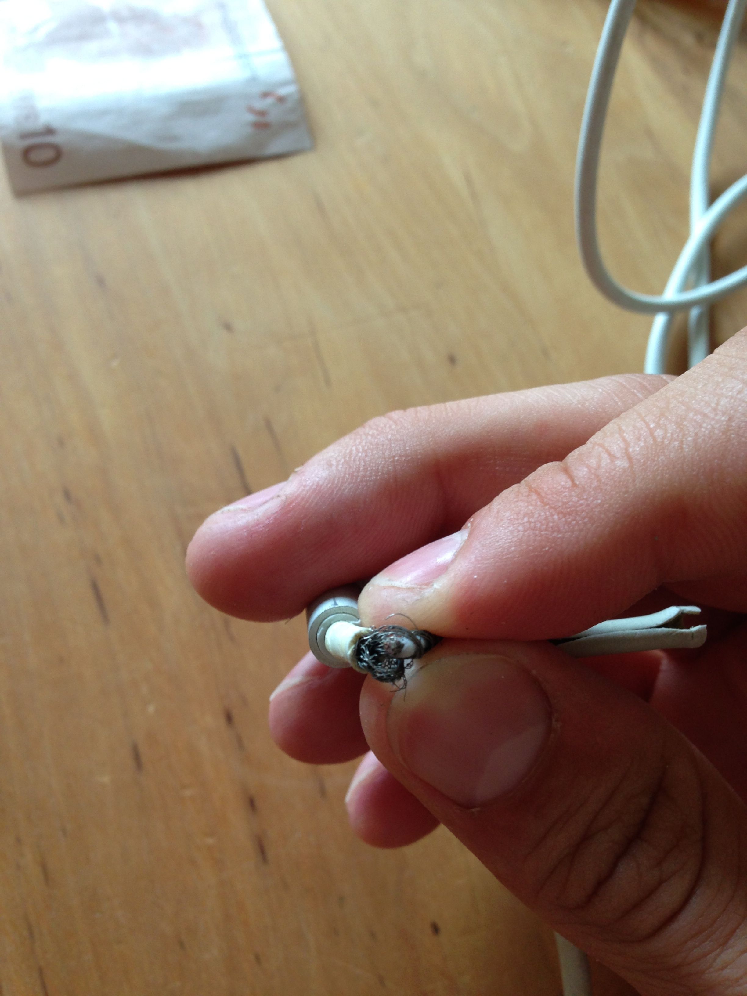

So there are two cables inside. There are two different types of frayed Magsafes: the one where the outer insulation breaks and then the outer cable.
In the second one the whole inner cable breaks (both the cable and the isolation). From the outside this looks the same as the fist.
I removed the insulation and separated both cables. (and also removed the insulation of the inner one). The general idea: if they are properly connected, it should work, so I tried it:
Success! Next step: make it last!
