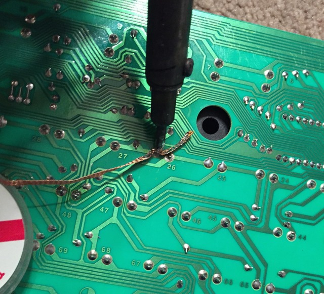

With the circuit board free, your first challenge will be locating the appropriate solder points for the key switch that's giving you trouble. Each switch has only two solder points. The switch is open when not pressed, but closed when pressed. Looking at the bottom of the keyboard will show that each pair of solder points is numbered, but unfortunately these don't generally mean a whole lot :rolleyes: . I found it easiest to eyeball the location as best as I could, then use the VOM to test for continuity at the contacts while pressing the keys. Unfortunately, this isn't infallible, as a failing keyswitch will often register a high resistance or even infinite resistance on a single press. Repeated firm presses will usually get the needle to peg-or a beep if you are using a digital VOM with a continuity function.
Once the correct contact is located, the next step is to desolder the switch from it. I've tried several desoldering tools, and have settled on the braid as the best option for me. Basically, this is a tightly woven mesh of copper wire that is placed over the joint and then heated with the iron/gun. As this is done, the solder is drawn into the braid through capillary action. The braid has a limited capacity, and will need to be periodically trimmed and discarded. Even so, I've found that-overall-it gets the joints cleanest. When using a braid, just remember that copper is an excellent heat conductor and will get very hot, so don't attempt to hold the braid directly in your hands(I put this reminder in for myself as much as others).
It takes a few minutes of work, but eventually the switch contacts will be free.

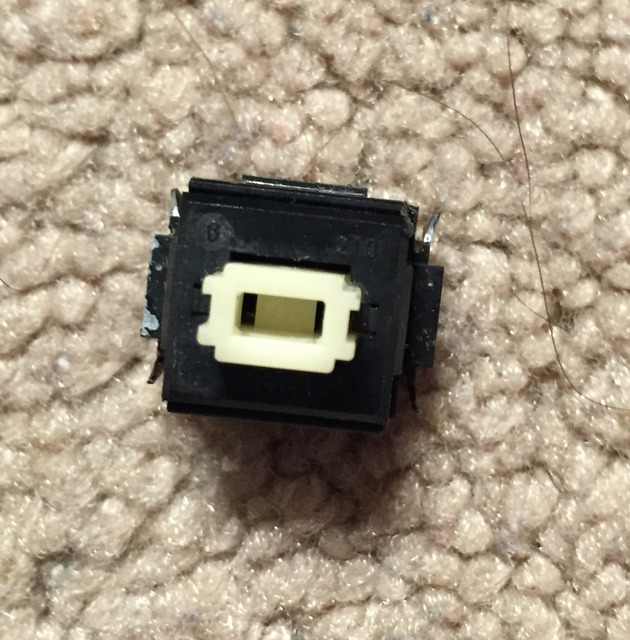

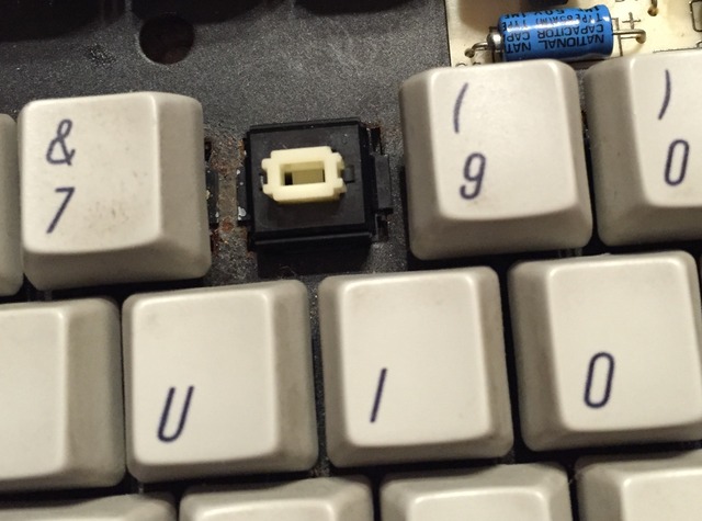

Once out, the switch(with key cap attached) will look like this

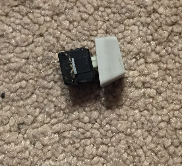

And the keyboard where the switch was removed like this
The keycap can easily be popped off to leave this

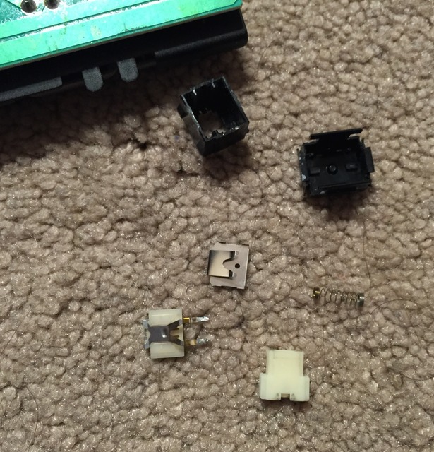

From this point, the switch can be disassembled. This is done by carefully prying the tabs on the "top" and "bottom" side outward, and simply pulling the switch apart. I'll add a caution at this point that the two solder tabs on the bottom need to slide through fairly narrow openings in the bottom of the keyswitch. If they excess solder build-up, they will not go. Thus, they may need some additional attention with the desoldering tool.
The fully disassembled keyswitch looks like this
The large plastic piece at the bottom is the armature which the keycap presses, and the spring provides resistance. The "springy" metal piece has two fingers on it. Not shown-on the other side of the part with the solder tabs-are two corresponding fingers.
With the switch apart, I do a couple of things. First, I very lightly polish all four of the contacts with 2000 grit sandpaper. I then carefully bend then slightly outward from the base(using a knife blade for backing). This whole process really is not very involved, and takes me just a couple of minutes once the switch is apart.

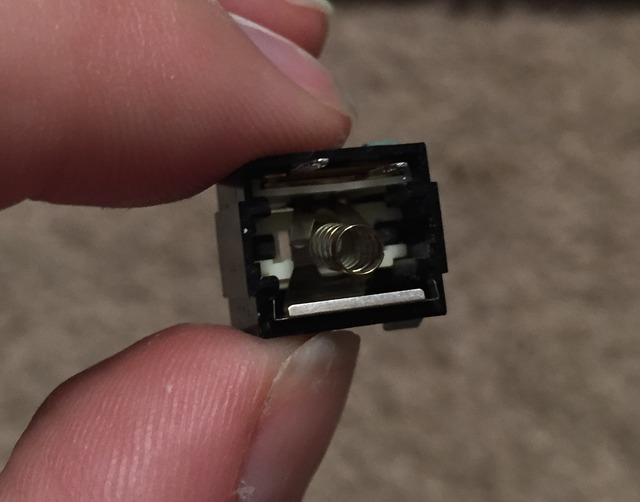

I reassemble all the parts in the top of the switch(there's really only one way for them to go in)
And then snap the bottom back on-making sure the two solder tabs pass through their corresponding holes in switch bottom(it won't go back together if this is not done).
I then use the VOM-again-across the poles of the switch to confirm that it goes from infinite resistance to no resistance every time the switch is pressed. On an analog meter, the needle should peg every time, and a digital meter should beep every time. If not, take the switch apart and try again.
