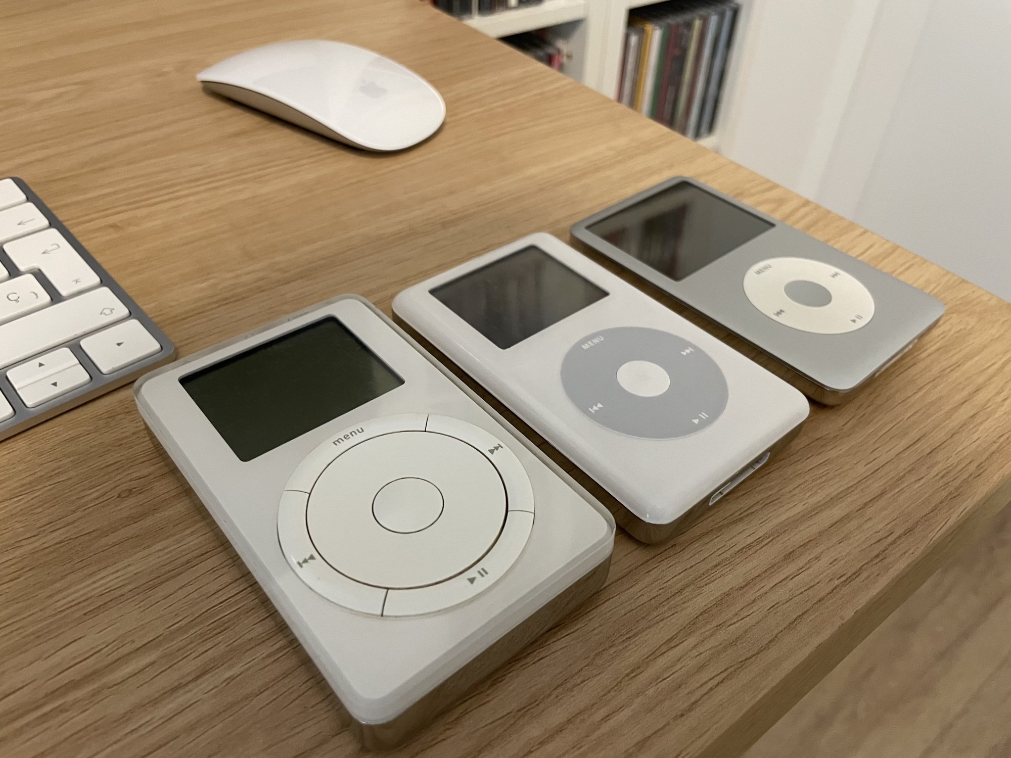

Hello all, I've recently purchased a 1st get 5gb. Long time searching for a good one to complete my classic iPod trio:
