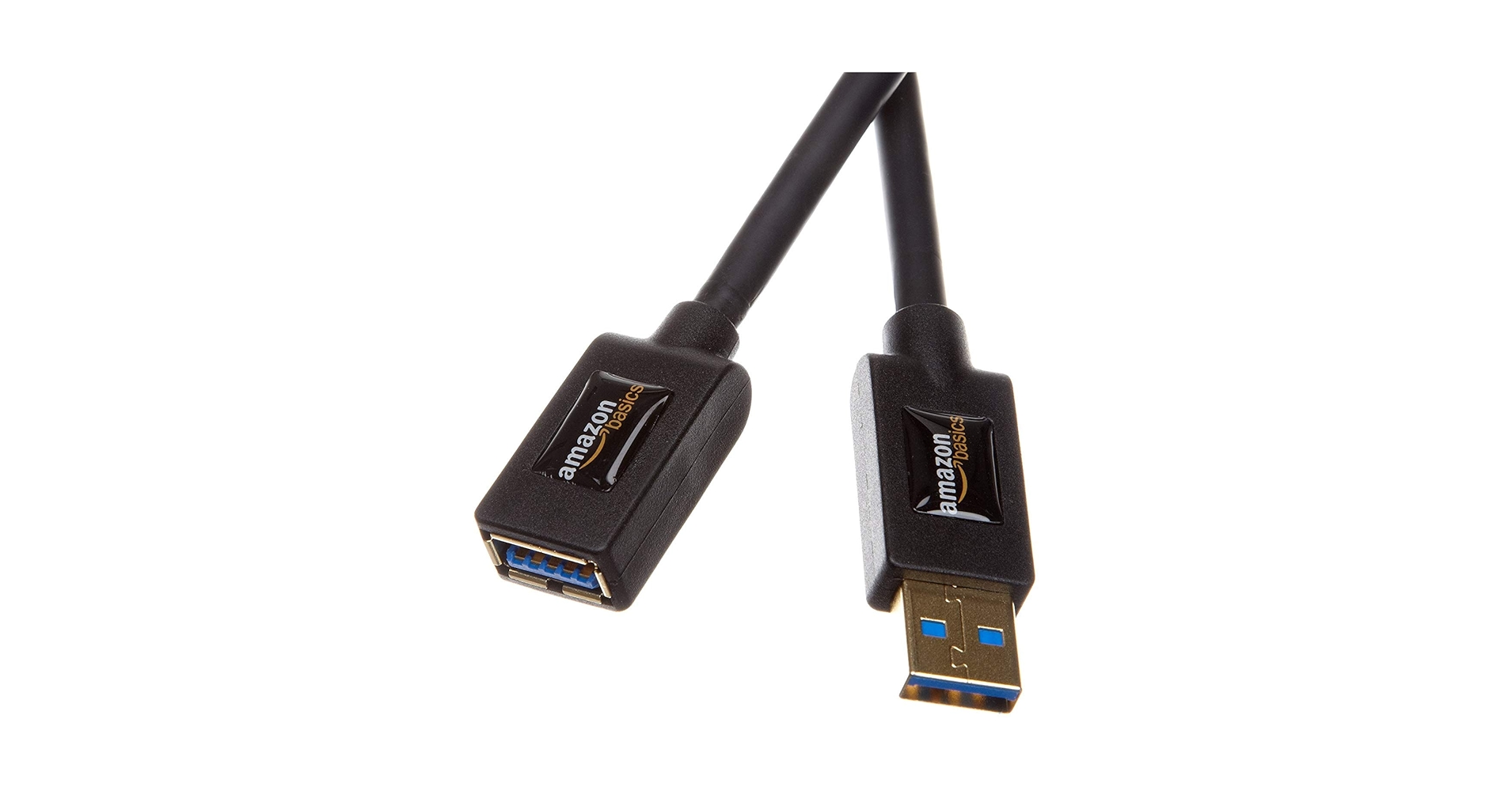

Placement of the antennas is important, esp. as distance increases or if there are obstacles in the direct signal path. Moreover there are all sort of secondary paths reflected off of things that can create all sorts of weirdness.
The MP7,1 is a huge block of aluminium for the purpose of an EM signal and that's not going to allow signals to go through it (no metal allows that), as well as that it might well reflect such signals, and that reflection will create all sorts of additional paths that will only interfere more than that they help.
Best choice: use an extension cord and put the receiver as close and in direct line of sight to the devices it communicates with.
BTW: the MP7.1's antennas for Bluetooth and WiFi are on top of the case AFAIK.
There's nothing Apple or any other computer maker can do to help you place it better in all possible positions a machine might get used in all environments. Before you know it somebody would put the antenna in a faraday cage and then complain it doesn't work.

I fixed my logitech connectivity issues by getting their dongle extender which allows the dongle to be just inches away from the devices:
Yeah, and Lightspeed peripherals actually do come with extension cables also.
