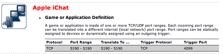

mpw - you might want to do a search for trigger ports. My router wouldn't allow voice/video chat through until I discovered a trigger port setting and suddenly, ta da! But as I said above, I'm at work so can't tell you what it is.

There's an easier trick if you've got the Be router - you just go into the profiles and they've very helpfully set one up for you called Apple iChat which magically works - and is the only reason that I found out about the trigger port since someone with the same router on a different ISP was having no joy.

Here's what my router had as its presets for iChat - and which allow me to audio and video chat
attachment.php
attachment.php
I praise you. I am going to enter those ports right now and report back. thanks!
