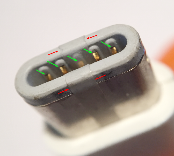

A “Hail Mary”… v.2?
Here’s something else you might also try.
Some of these monitors had/have an internal “grounding problem”(?). At any rate, had one here that exhibited similar symptoms as yours - and “found” somewhere that if you cover the two center connection pins inside the power plug with cellophane tape, the display then works fine.
That’s 10 pins total (5 per side / green arrows) but only the two middle pins (both sides) need be covered in this manner. Hopefully you can see in the attached pic where both have been covered with tape strips. AND that slim tape strip needs to cover ONLY those two pins all the way down into the plug.
Apologies for the dirty looking plug (this one was out in the garage).
But this approach did/does work on this particular monitor… here.
