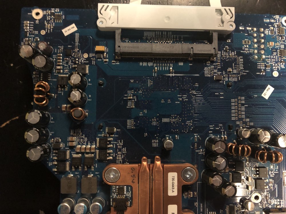

recently i've found a 2006 24-inch iMac getting recycled, which has the fans spinning up and no display or chime. apparently for the diagnostic LEDs, LED 4 doesn't light up. i think this means that the motherboard and the video card aren't communicating. so i have a few options: spend some money for a radeon 2600 pro from a 2007 iMac, pay a lot of money for a 7300 GT for the 2006 iMac, or just remove the card to see if i can get integrated graphics working. note that i would be ordering these cards off eBay for whatever price they have. also i have discovered that 3 capacitors are bulging on the motherboard. imaccaps.jpg

that might have been it! however i actually forgot to plug the LCD in and when i did, i turned it on and the screen flashed white for like a second, and it turned off along with the LED turning off. definitely something to do with those capacitors, i'll replace them soon.
