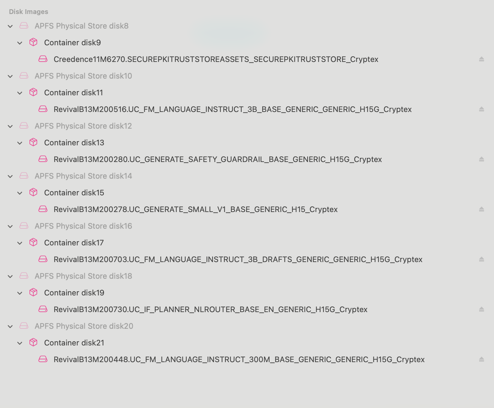

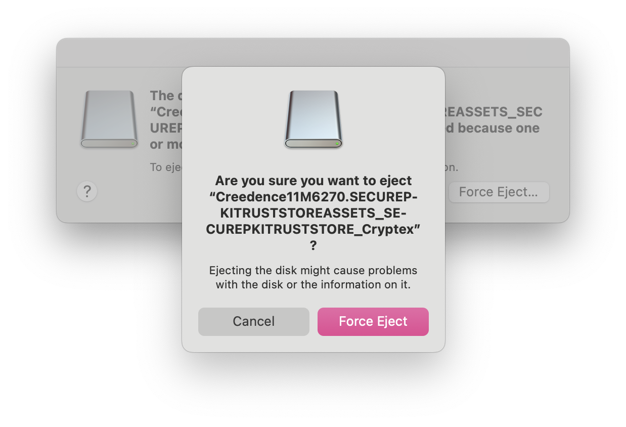

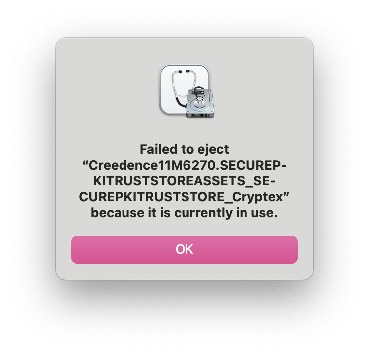

Hi,
does anyone know, where those could come from. They were suddenly there a few days ago.
I can't eject them and when I click on "Mount" at the greyed out disk just nothing happens.

I am jealous. I only have the Creedence cryptex. Intel macOS 15.1 with no betas.
I know cryptexes have been around for a while, but I don't understand why they are now being mounted like this in Sequoia when they weren't under Sonoma, etc.
… after restart they remain?
My single cryptex does.
I will update to 15.1.1 later today and see if that changes things.

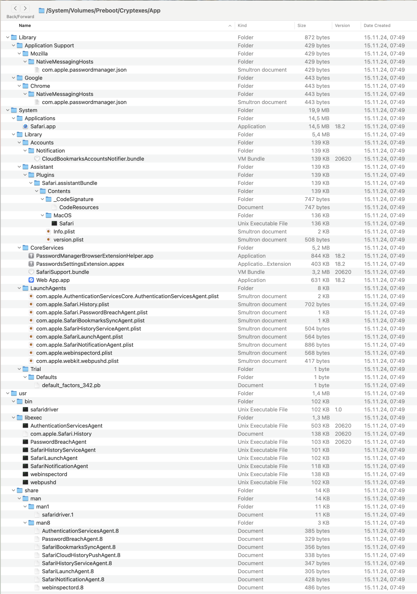

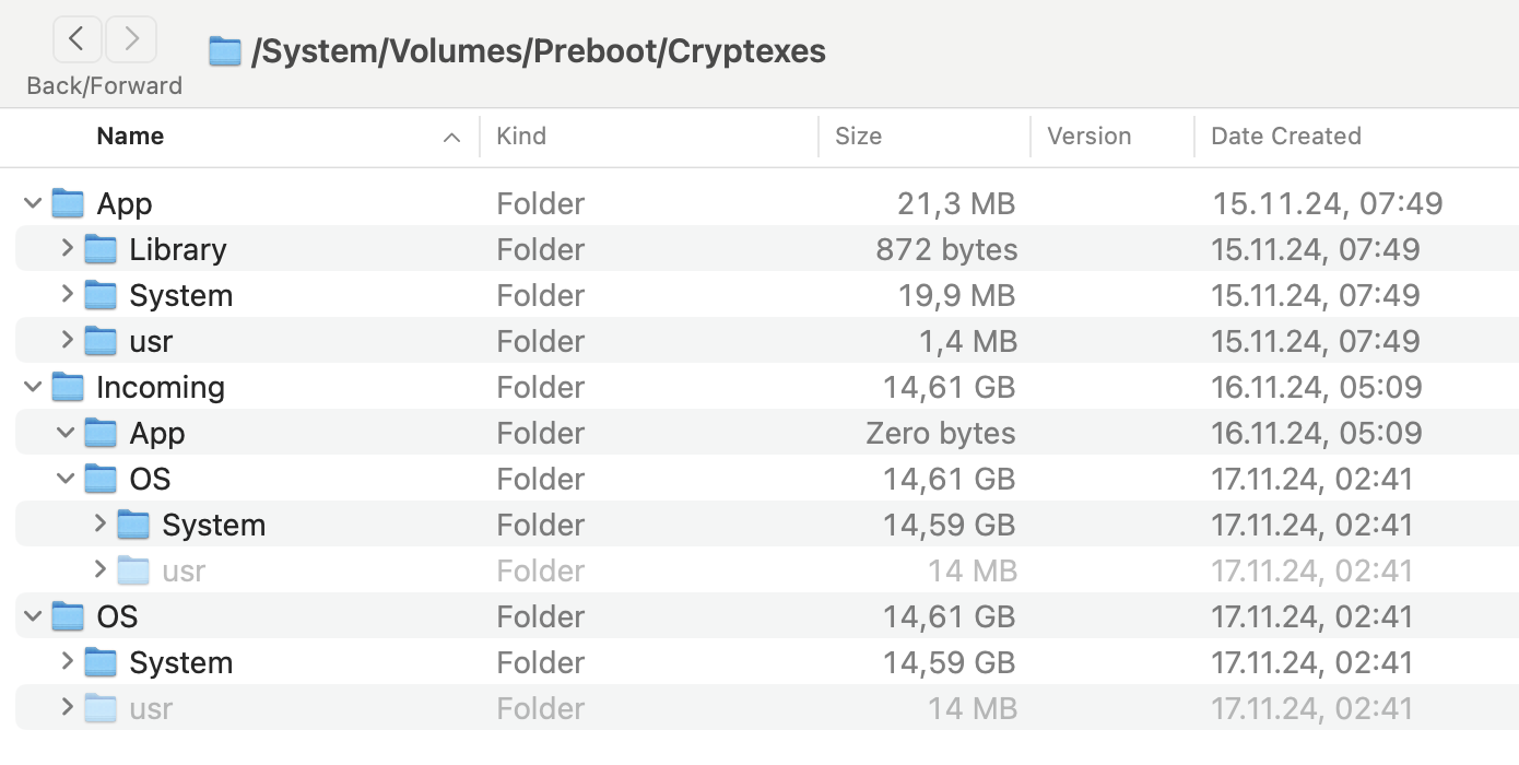

But I just saw there is a folder called Cryptexex in the System Folder that lead me to
/System/Yolumes/Preboot/Cryptexex/App
what includes things like Password Managers from Mozilla, Chrome, Apple and many Safari stuff, even the Safari app itself. It's all created on the same day and time.
Here is all what it includes:
The Content of the OS folders looks like a macOS installer.
Reactions: Patrice Brousseau
Yes, that is what I see. /System/Volumes/Preboot/Cryptexes/ is where I expect to see cryptexes. That is contained in the Preboot volume. These are all dated in November which is what we might expect.
The files in the Creedence cryptex are dated 2-July-2024. Maybe that is the last time the list of PKI certificates was modified. All very strange.

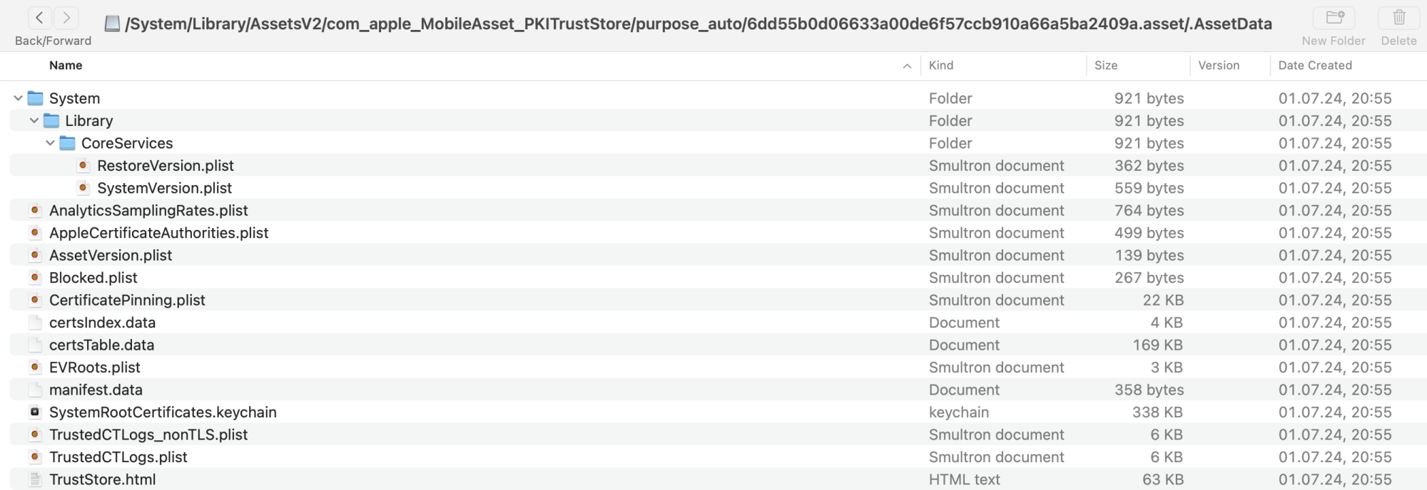

That's exactly the first one I can see in DiskUtility.
When I open it there are those files:

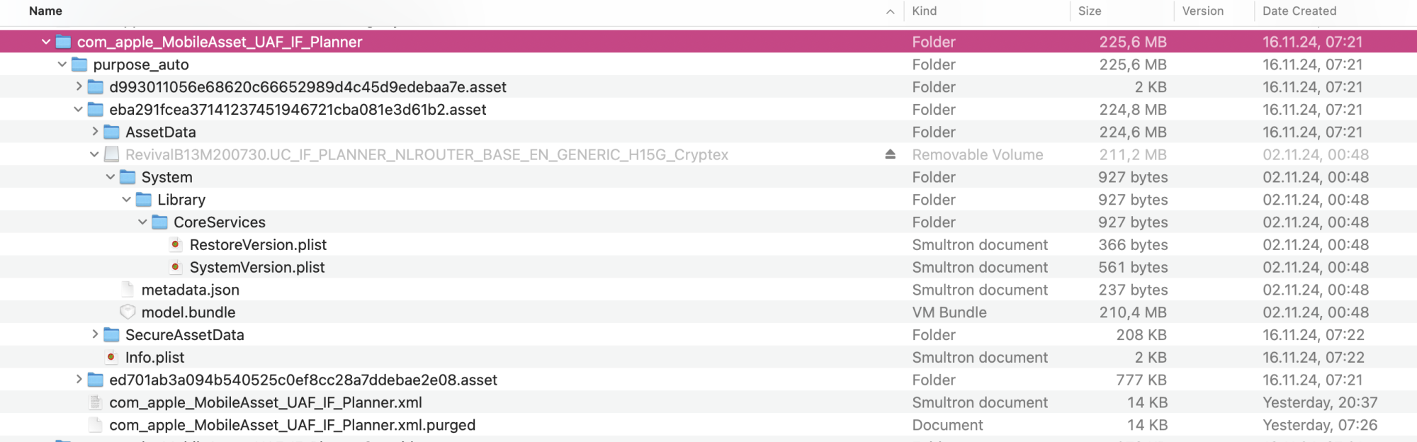

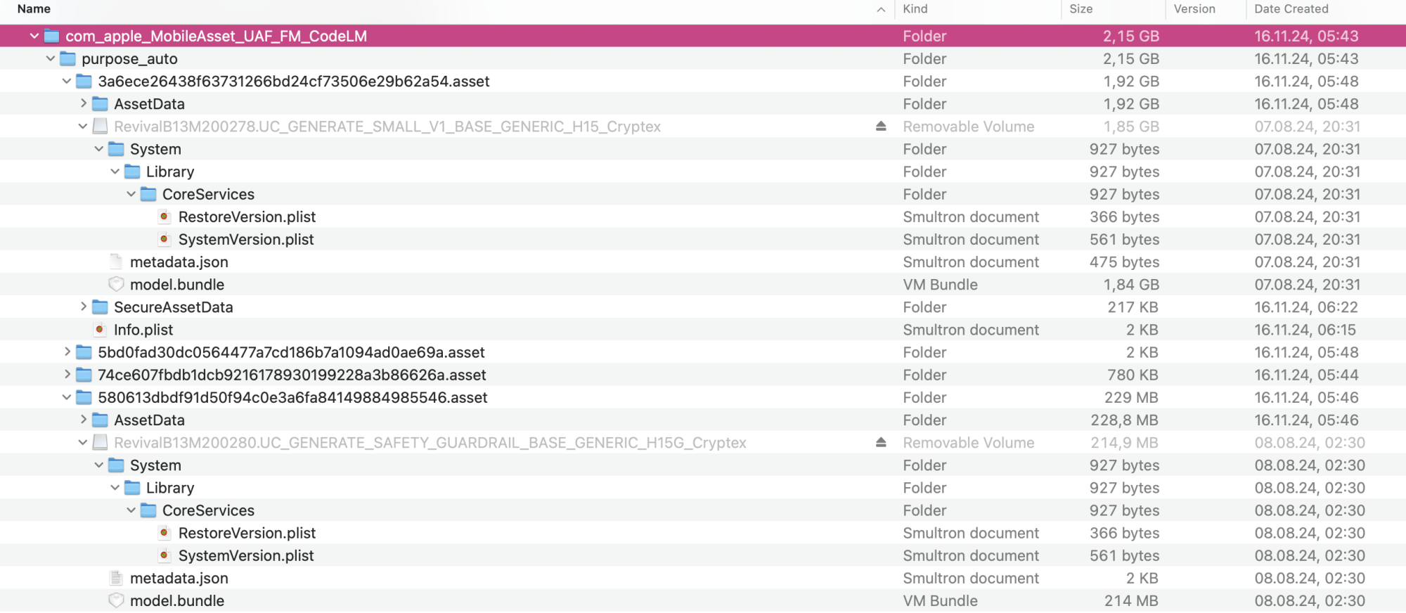

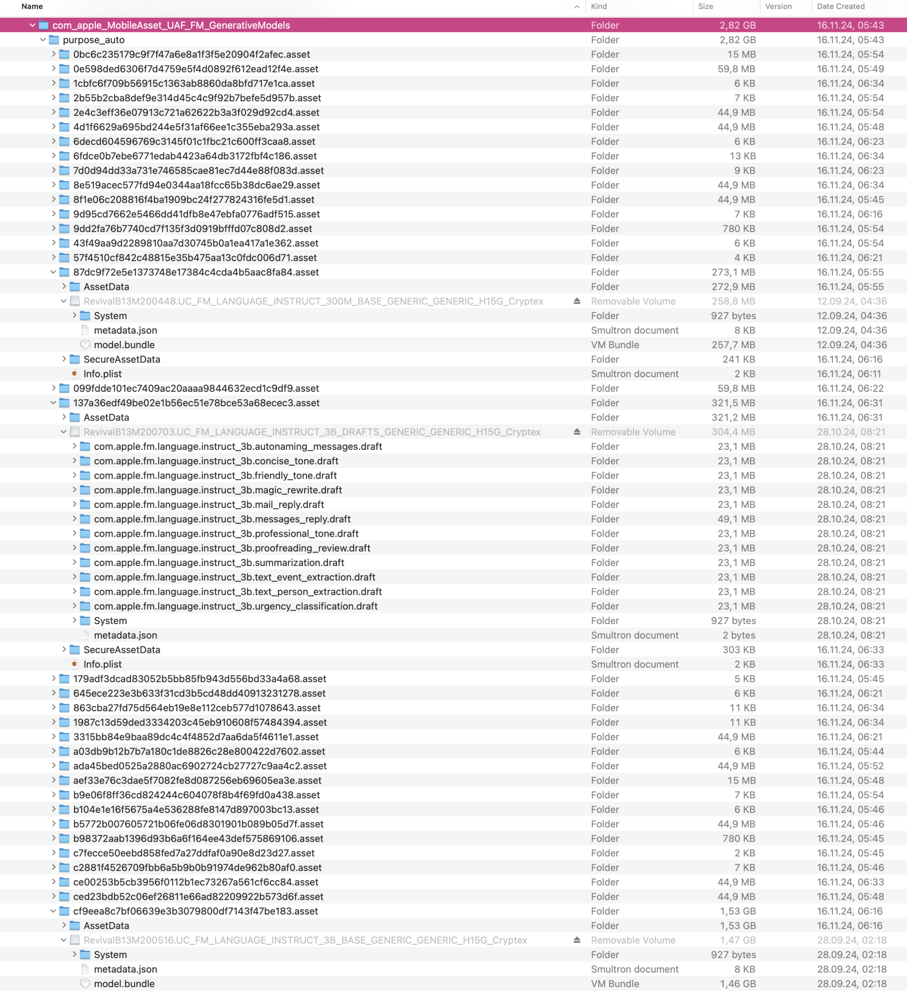

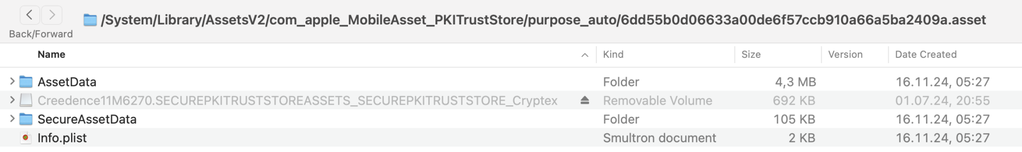

The other ones are also in subfolders of System/Library/AssetsV2.
Do you know what this UAF is?
At first I didn't know I can just click "Show in Finder" in Disk Utility to find them. And searched for half an hour without finding anything. 🙈

Yes it's just a little annoying if you have many external drives and often use DiskUtility. I removed them all to test if it's coming from one of them, but seems to have nothing to do with the other drives.
I just see the three that were gone are back. Now there are again seven. :confused:
That would be really annoying if they are all also on the Desktop.
