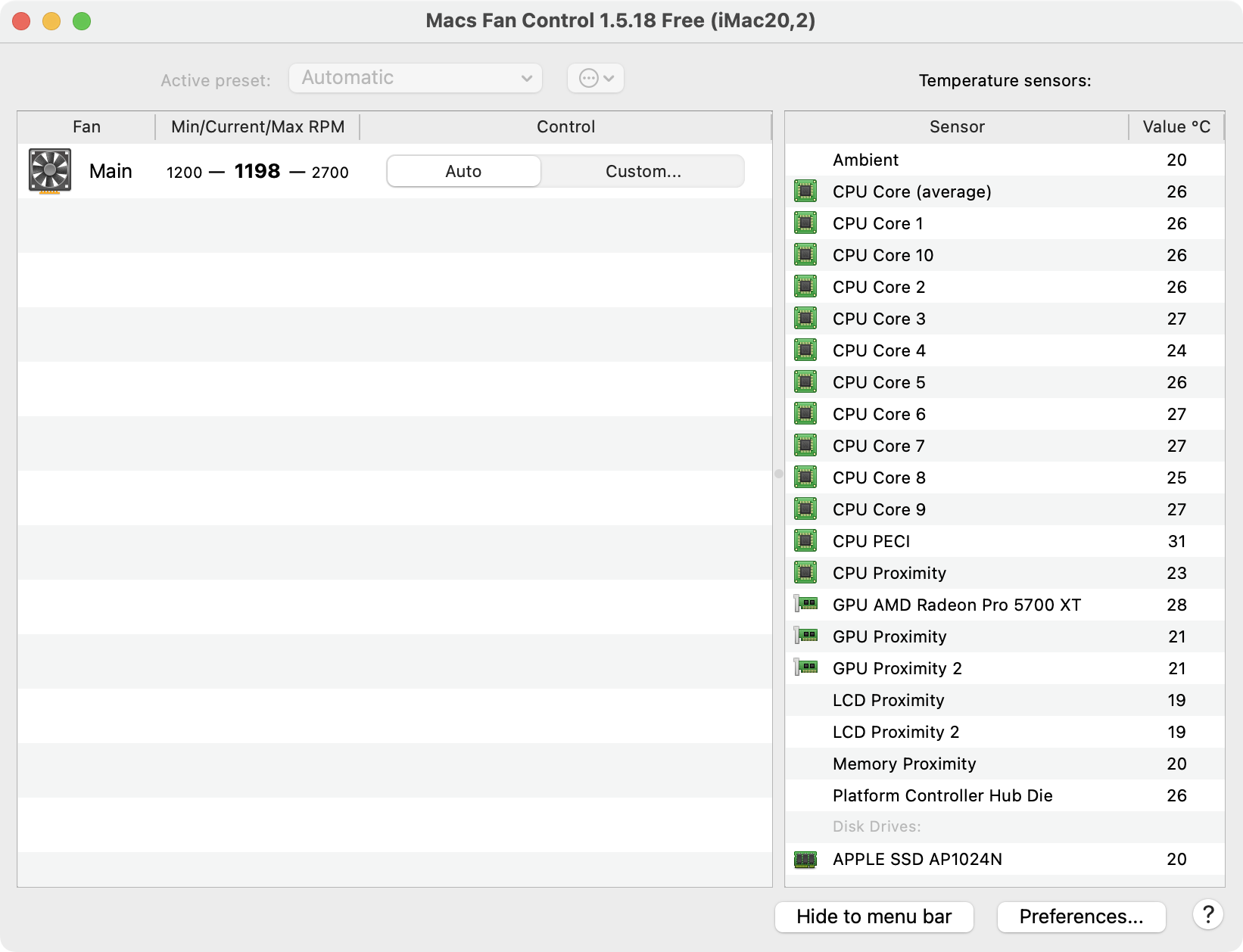

I'm back home, and the computer is currently behaving normally. I've run Macs Fan Control and taken a look, and everything seems OK to my layman's eyes. It'll be interesting to compare if/when the issue recurs.

I'd be amazed if it was. I've had the machine for almost five years and I've never heard the fan go that loud before. It doesn't ramp up, but just goes from the slowest speed right up to the fastest in about a second. It just happened again, but only for a few seconds: I couldn't even get Macs Fan Control open before it returned to normal.

Here we go, it just had another blast and I was able to get MFC open.
So that's higher than the "max" and I don't know why. It had returned to normal by the time I got Activity Monitor open.
