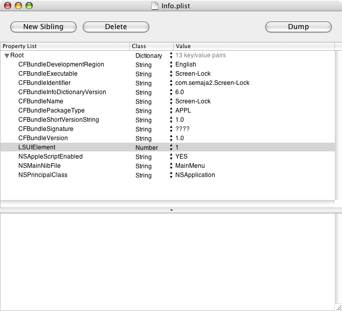

I don't get the part about hiding it.
EDIT: Yup, I definitely must be missing something about making it hidden, because this isn't working:
I also tried String = 1, and Boolean = Yes

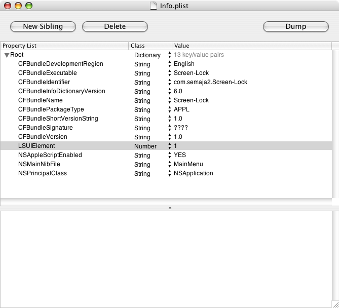

Make sure your editing the correct info.plist, the one your looking for unless your recompiling in xcode is the file inside Screen-Lock.app
So select the application and select "Show Package contents"
PS. to edit the idle time (60 sec by default) use the following command in terminal
defaults write com.semaja2.Screen-Lock idleTime <time in seconds>
PSS. Its a number for the setting:
<key>LSUIElement</key>
<integer>1</integer>

Clarification
