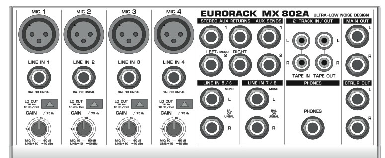

Thank you, e-clipse, for your fast response. Here's a drawing of the top part of the mixer. It has a Main Out L and R and a Ctrl R Out L and R. Dumb question alert: Are those the stereo outs?

unless bear-ringer is doing something i don't know about, do *not* connect the midi out to the mixer. take the audio out(s) from the keyboard to the mixer.
then you can either:
1. play the keyboard
2. have the computer play the keyboard (via midi, from the keyboard to the computer, bypassing the mixer [because it doesn't know anything about midi])
Oh, so you're saying use the keyboard's headphone jack, basically, and just use an 1/8" to 1/4" cable to connect it to the mixer?
not the headphone out, there should be either an audio out or left and right outs.
the headphone out has an amplifier behind it, and you don't want that when connecting line level to line level. speaking of which, you'll use the mixer's line ins, not the mic ins.
I just checked again, and there's only the MIDI in and out, and an 1/8" jack that I plug the headphones into, although it does just say Output.
oops. guess it's one of those consumer models w/ speakers and no line out. oh well.
yeah, you can use the headphone out, but you'll have to play with the levels to find the sweet spot.
