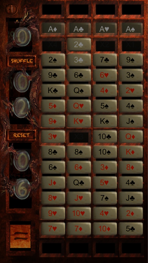

So I have an app that was iphone 4 or 3.5 only and it worked on the iphone 5 with boarder.. I updated it to be full frame and iphone 5 aware if you install it new it recognizes it's on a iphone 5 and everything is fine.
But if it's a the old version updated. This code doesn't seem to be working..
but it doesn't seem to be reading correctly. because size seems off.
Do I have to check actual models
***also any idea how to test this in the simulate upgrades, because the simulator and Xcode always seems to compile it as a new app. Which works fine
what it should look like.
What it does
*** The hint actually is that although both images came from a iphone 5 they are different resolutions.
below is 496 × 880 pixels well above is 640 × 1136 pixels wacky.. I would think the iphone5 would just stretch the image not change screen resolutions.
What it does
