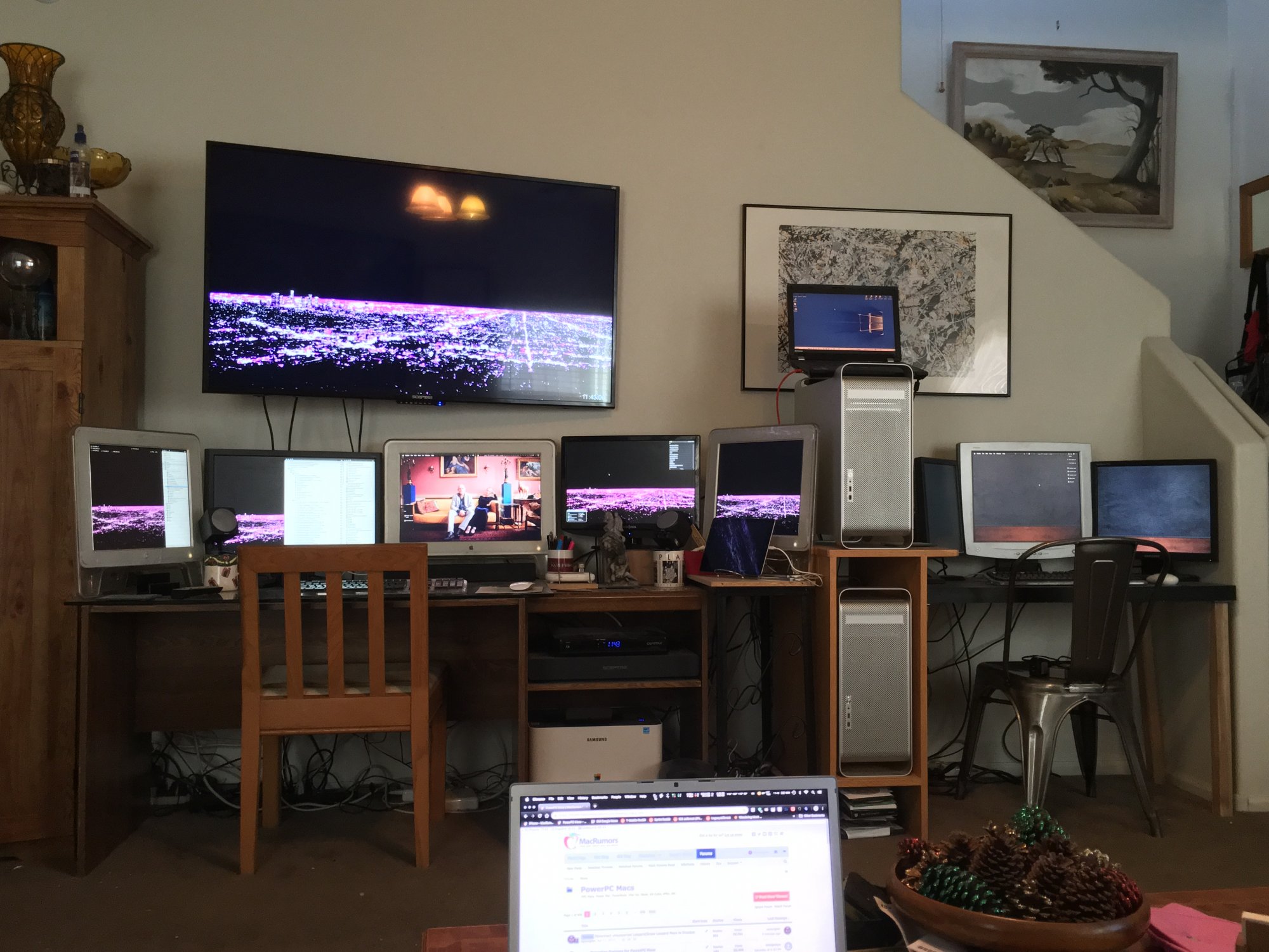

I had six attached to my old Quicksilver. When I got my G5 Quad I migrated those six to it and then on to my Mac Pro. I also have four displays attached to my 2.3DC.
For the Quad I used a Radeon X1900 XT and two of the stock NVIDIA cards.
Below is my Mac Pro, but these displays were previously attached to my Quad and as I mentioned, my QS before that.

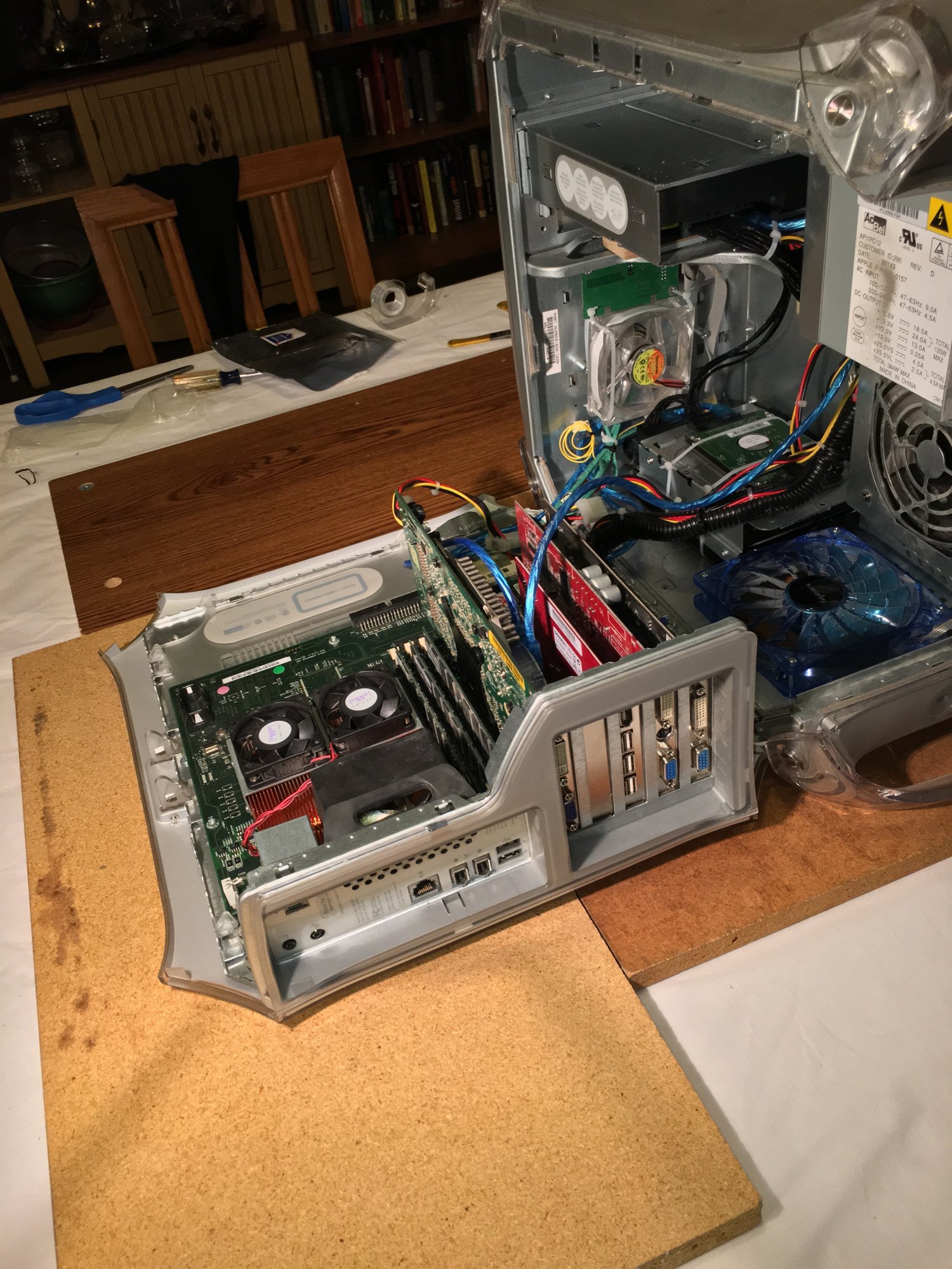

Quicksilver: https://forums.macrumors.com/threads/quicksilver-beautification-project.1953562/

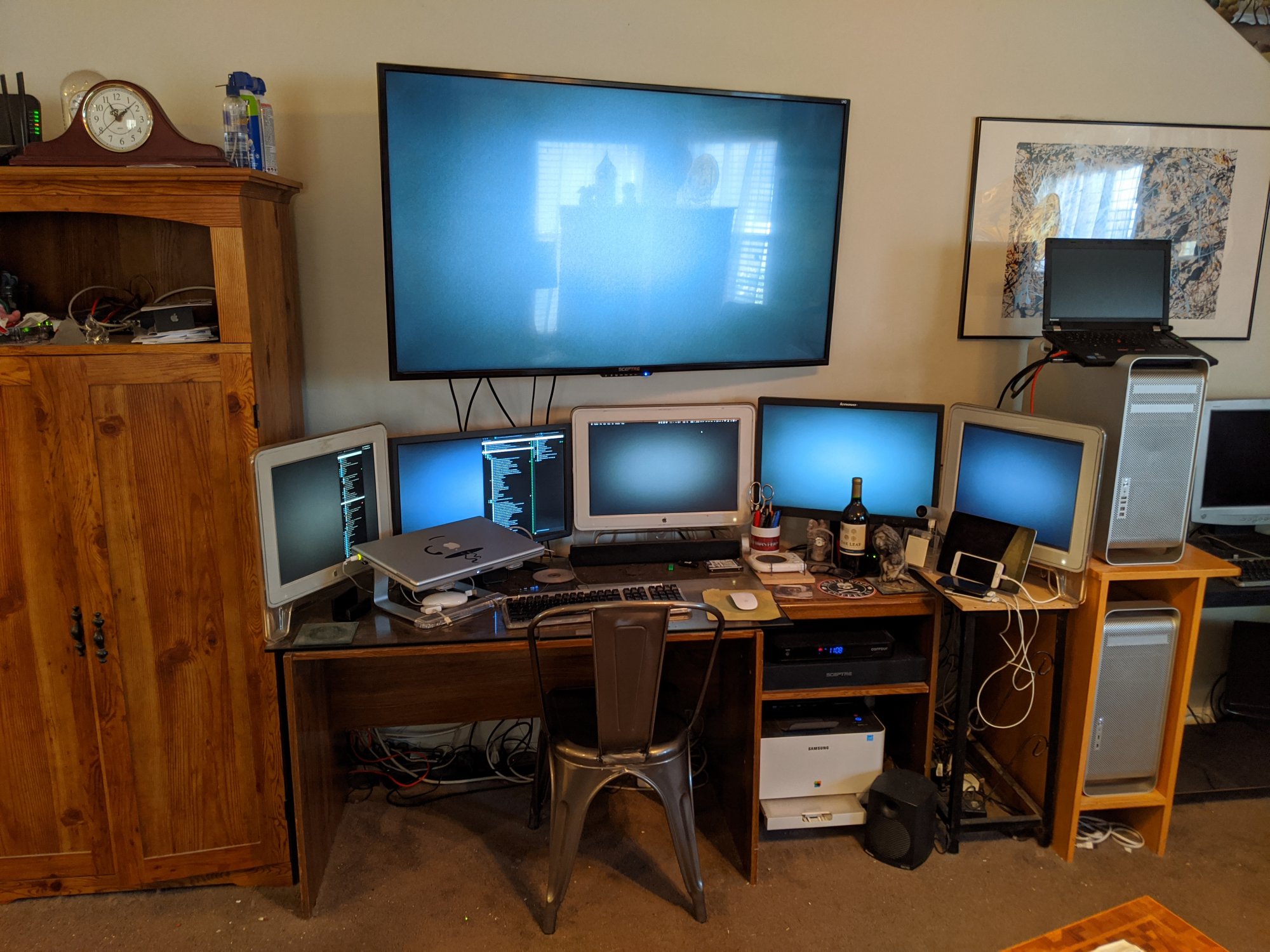

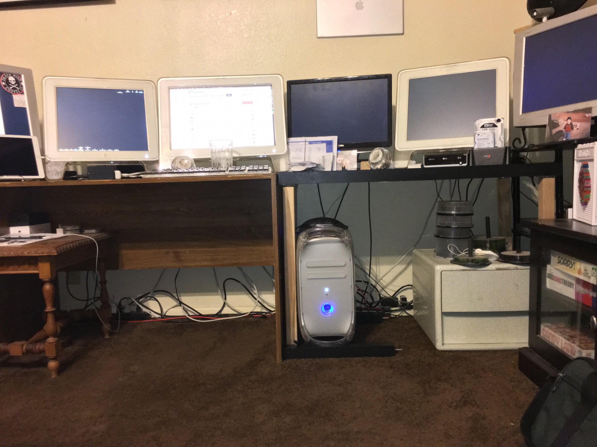

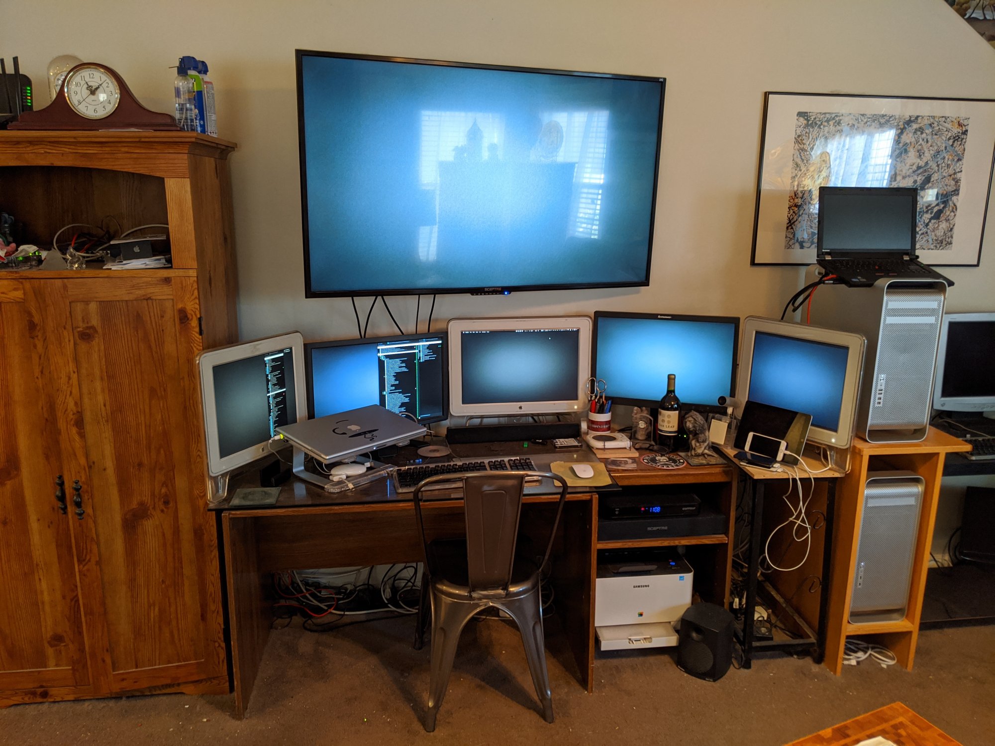

EDIT: Quad G5 with six displays and 2.3DC G5. This is an older pic, the two monitors between the Studio Displays and the Cinema Display have changed over time.
