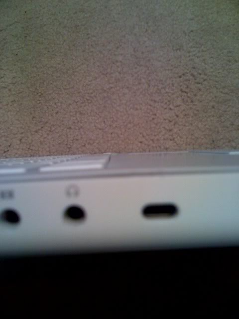

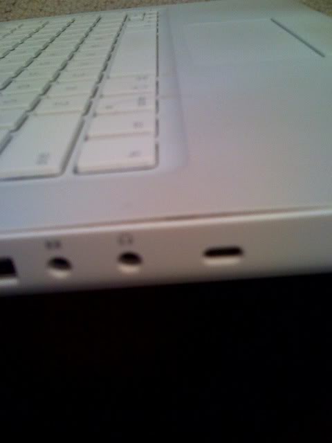

So today In examining the area near the line in and headphone inputs, I noticed that the edge of the computer is a bit risen. Possibly a sign of something?
