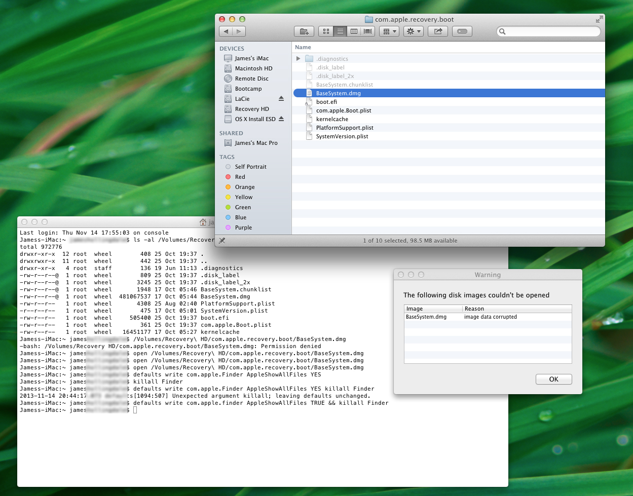

I mounted the recovery partition using disk utility (developer mode). When I try to open base system.dmg on the recovery partition it tells me the dog is corrupt :/ This would definitely help explain why the recovery partition does not boot up...
The question is why is it corrupt - I did an upgrade to mavericks as soon as I first got the machine. Maybe the rec partition was bust at that stage, I never tried it so I don't know.
I just replaced the base system.dmg with the one buried inside the mavericks App Store installer. Hey presto I have a working recovery partition again!
