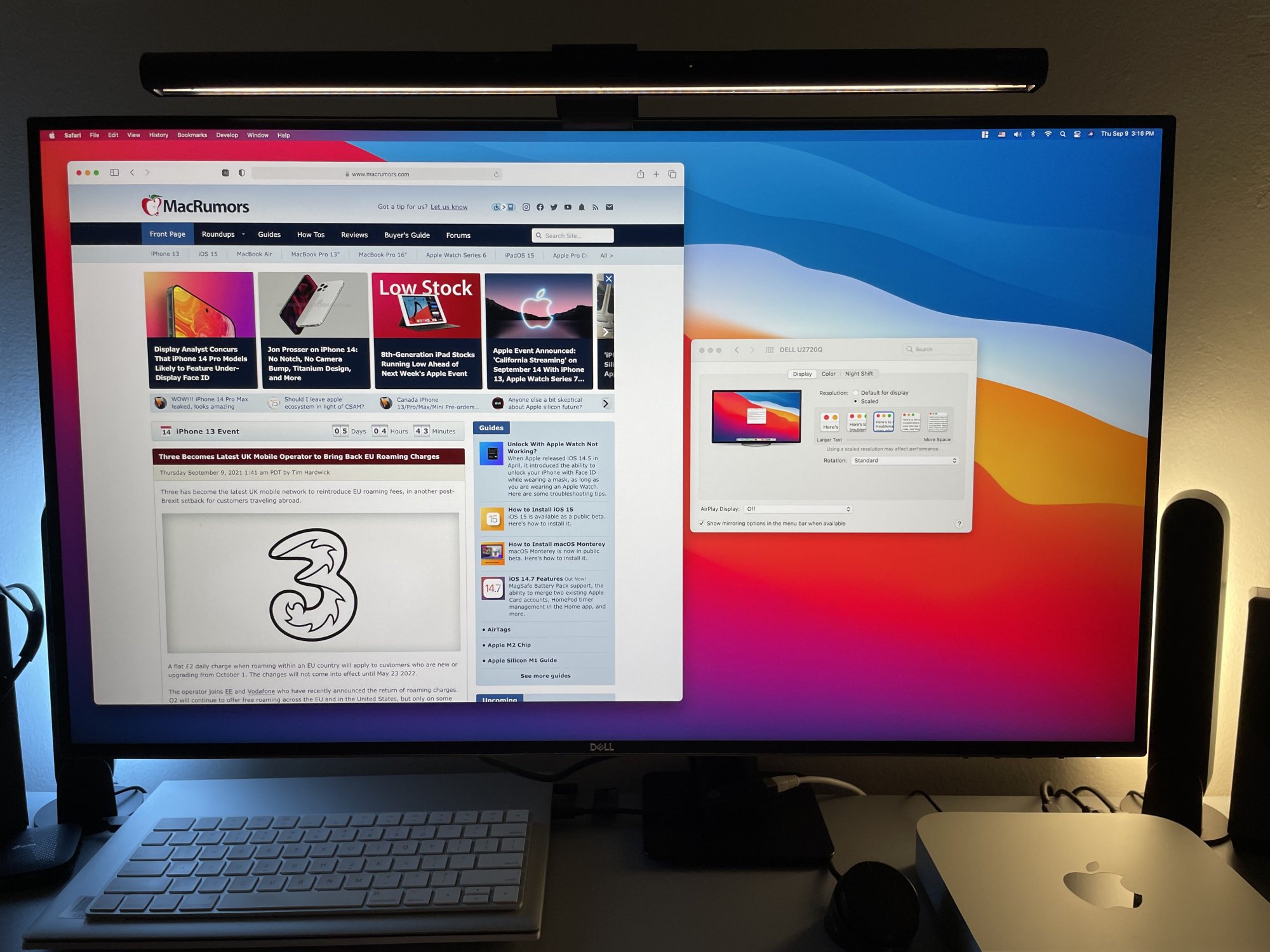

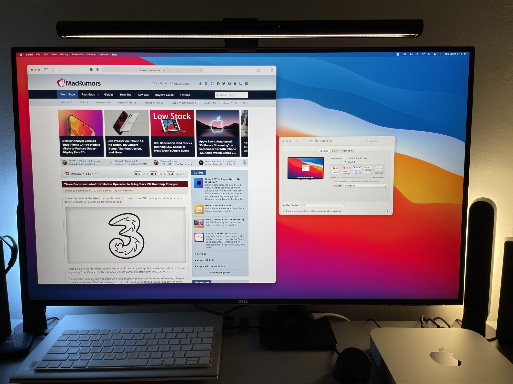

I use that specific monitor with a M1 Mac mini and the 2560×1440 setting, and I am really happy with how it looks. Crisp without the interface being too small.
I use that specific monitor with a M1 Mac mini and the 2560×1440 setting, and I am really happy with how it looks. Crisp without the interface being too small.View attachment 1828699
Oh thanks, I can´t see the sharp text from the photo; but it looks good. Have you ever use an iMac 5K to compare?
