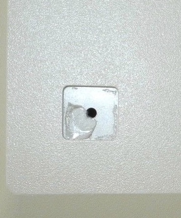

EDIT - pic of hole with badge removed:
[doublepost=1511537888][/doublepost]If you've not taken one apart before, then that's a whole other ball-game.
