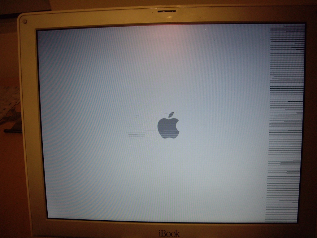

WHOA! It works! Well, sorta.
I just restarted twice and that trick doesn't work any more. Still, I'm assuming this means there's something I can do to fix it?

by the looks of it, it is a logic board issue, id try to get on ebay and see if any are there, you could also try opening it up and checking if the GPU (on the underside) is loose. It could also be a different issue with the video circuitry. In which case it will have to be a new GPU or Logic Board.

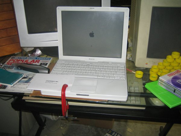

I don't suppose I could put a big C-clamp over the trackpad, could I? 🙄
Generally, any kind of shim inserted between the case and the GPU will do the trick. It's fairly easy to do, iFixIt has a guide on it.

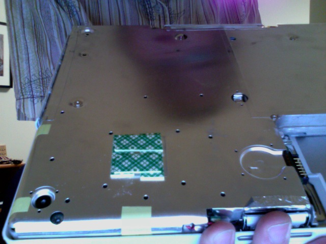

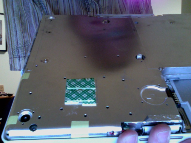

I just put a double layer of padded double-sided tape, with the backing still on, on the outside of the heat shield over the square bit. Should I be worried about the GPU overheating?
Okay, I did a bit more reading and figured it's better to be on the safe side. I replaced the first layer of double-sided tape with 4.25 pennies (one cut up to fill the bit in the middle). Copper is a good heat conductor, so all should be good now.

Well, it worked for a while, then it became quite unstable and is no longer working at all. I guess I'm out of options now? Would this "reflow" fix the logic board or is the problem bigger than just the graphics chip?
If failing solder joints are your problem (and it sounds like they are), then yes, a reflow is a long-term fix for the issue.
If the shim method works then yes, the reflowing of the solder will work. Usually if the shim method doesn't prove useful anymore, I don't think it's worth to get it reflowed. I think I remember reading that in their fine print ages ago 😛.
They do however provide a 1 year warranty if the problem comes back. You just need to dismantle it again and ship it back.
