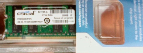

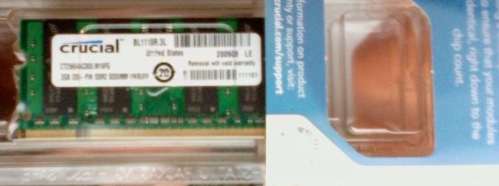

Just wondering if the ram from crucial says Micron. Crucial sometimes will sell other ram from other manufacturers other than their parent company Micron.
Here is a pic of the ram
Thanks for the picture.
I guess I wasn't clear. I actually wanted to know was the actual chip on the memory module from Micron. The black chips are they micron?
If crucial is using someone else's chips, other than Micron. I might just order from OWC. Crucial charges more than most suppliers. Thats Ok, with me. If I know their going to send me Micron ram.
Strange, That all 4 of the sticks they sent you were bad. I always heard such great things about Crucials quality control. Hope you get a speedy exchange with some good ram this time. Let us know how they work.
