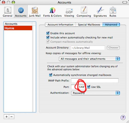

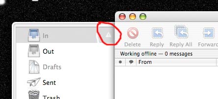

I've use Yahoo for a while and I get sick of getting emails for 'male enhansment,' so I've decided to try Mail. I know you can't use the free Yahoo account with Mail, so I signed up for a Hotmail account(I've already got the hacks to make Hotmail work). I've made an account name and password and all that stuff. I enter my account name and everything, so far everything is going good. I quit Mail, realaunch it, select my inbox, but right next to it is a sign that looks like a yield sign (see pic). I click on it and get the error:
The server error encountered was: The server “musicpyrite89^hotmail.com” cannot be contacted on port 548.
This sucks, ok, so I open up the prefernces and click account. Then I got to the tab that says 'advanced' and I try changing the port(see other pic) like a dozen times, and it still doesn't work. 😡
So what should I do? Can somebody check and see what port your using? Or is there something else wrong?

I'm assuming you're using the httpmail plugin? If so, then it looks like you've got the wrong account type set (the Advanced section shouldn't look like that). Recreate the account, and set the account type to httpmail.
Then fill out the other fields in the Account Information tab. For incoming mail server, type 'hotmail.com', and you can leave the Outgoing Mail Server as none.

Different account types have different options in the Advanced section. So, since the httpmail account type has different options, the interface of the Advanced section is different. The screenshot looks like the Advanced section of an IMAP account, not an httpmail account. Sorry for not making that clear.

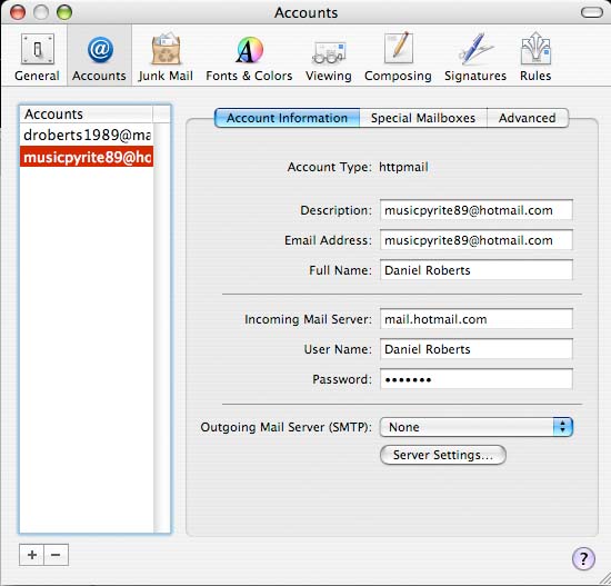

HexMonkey: I moved all the folders you said to, but now when I try to connect, I get the yeild sign again(see pic).It says this:
Could not connect to 'musicpyrite89_hotmail.com'
Service Unavailable
I'll include a pic of the account information, in the prefrences. Mabey you can tell me if I entered something wrong.
Note: I did reinstall the hot mail plugin, and I did check the box that says 'enable this account' under the advanced in the prefrences.

OK, I've been messing with the settings, I know what I messd up on, the user name was suppost to be my email address. Thanks for all the help HexMonkey. 🙂
