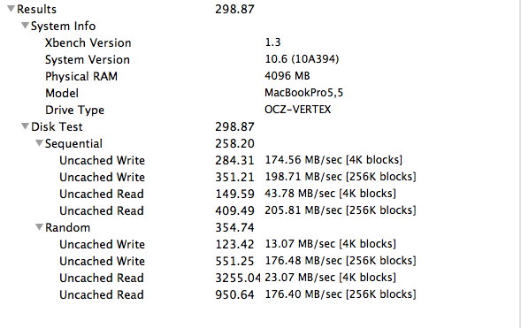

Here what worked: After almost 2 days trying to get my Vertex works with the machine I decided to try a different approach.
I had a Optibay like enclosure laying around and I decided to give it a try. As a result, the drive is super stable connected to the optical drive sata cable.
See the attachment for X-Bench Result
Here's my question to those with SSD and June uMBP, is your SSD connected to the Superdrive Sata cable of to the HDD one.
