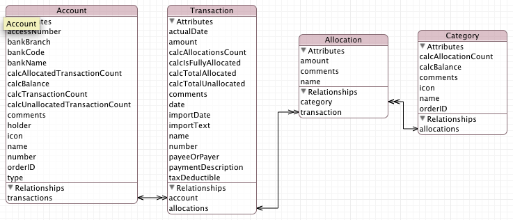

I have an entity that defines a transaction. Most of the time the transaction will simply involve an addition (e.g. receiving a shipment of 10 widgets into department A) or a subtraction (e.g. dispatching an order of 3 widgets from department B).
However, sometimes a transaction may be a little more complicated. For example department A may transfer 2 widgets to department B but as the departments are located on opposite sides of the globe department A records the subtraction transaction as having occurred on 16/07/2009 while department B has a long weekend in their country and doesn't record their addition transaction until 21/07/2009. They also give the transactions different names and descriptions.
I would like to be able to reconcile these two transactions in my application once they are completed. Obviously I could add additional information to the transaction entity to allow this (i.e. Department A creates a transaction with a "from" date, name and description but with an empty "to" date, name and description) which department B then fills in. This doesn't seem ideal though.
What I think would make sense is letting both departments create their transactions normally and then create a "transfer" entity to link the two. My question is, how do I go about this? Is it simply a matter of creating a "transfer" entity with a to-many relationship to transaction (with a min count of 2 and a max count of 2)? If so I guess I would then have to validate to make sure the transactions are compatible (i.e. count is the same, item is the same, receive date is not before send date, etc).
Alternatively, does transfer need two separate relationships to figure out who the transfer is from and to? If I create two separate relationships I then have to create two inverse-relationships in the "transaction" entity (transferFrom and transferTo) which seems to be a slippery slope towards the less than ideal solution I already mentioned.
I think I might have answered my own question while thinking through the alternatives but any input would be appreciated!

Thanks for your reply Luke! And the model for a finance application would be quite similar (i.e. departments become accounts and items are no longer necessary as the only item you're dealing with is cash).
Running with the finance example I have a few detail level questions:
1) Would you give the account entity opening balance and date attributes (and prohibit transactions before that date) or would you just make the opening balance another transaction?
2) The example you gave seemed to place more emphasis on transfers than transactions. I see my problem domain being reversed from that - as it would be in a finance application too I believe. Normally a person just deposits their salary or pays for goods, it's only on rare occasions they wish to transfer money between accounts (e.g. getting ready to pay a big bill). So I like the idea of transfers simply being two transactions but I still don't quite see how to link them...
The FROM transaction item has to-one relationship with transfer item which has a to-one relationship with the TO transaction item. However, when I try to model that I get confused as in the core data model there doesn't seem to be a way of differentiating between a "FROM" transaction and a "TO" transaction. Or do you just deal with that later when you're fetching the data?

Hi Luke (and anyone else reading this thread! =)),
Firstly thanks for your help and secondly thanks for making me think about double-entry accounting. I think I now know the BASICS of it... enough to understand why you put the emphasis on transfers.
I would just make it another transaction, at least in the database. You could predefine a transaction and make a separate interface for entering those amounts if you like.
Hmmm... having toyed with the options I've realised that you're correct yet again. But (and perhaps I'm looking at this the wrong way), is there a way to (or better yet a reason to) link from Account to a given Transaction as the "opening balance"? My thinking is that I will treat that opening balance transaction slightly differently in terms of business logic... for example checking to make sure new transactions don't predate the opening transaction.
I thought of having an "opened date" attribute on the account (and the transaction from that date is the opening balance) but that doesn't work in the likely event there are other transactions on that date. If I wasn't using Core Data I would simply use a linked list or other ordered structure as the data store and always put the opening balance in the root node but Core Data doesn't care about order. Does having a second relationship between Account and Transaction make sense? Ignoring the other attributes and relationships it would look something like (numbers represent inverse relationships):

Thanks for all your generous assistance Luke!

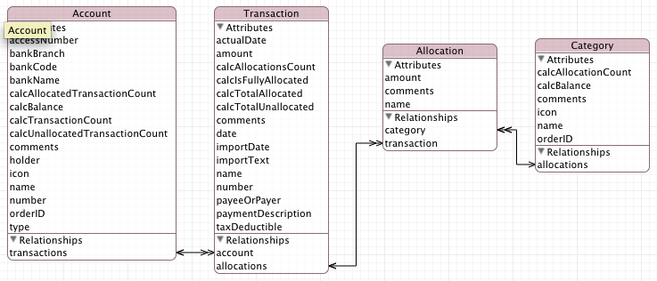

For anyone who cares I decided against implementing transfers at this stage for the sake of simplicity and to ensure I meet my deadline. I might reconsider it if there is ever a future version of the app.
I've also attached a picture of my core data model.
