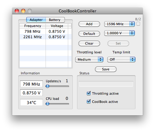

I'm running my MBP13 on the highest frequency with the lowest voltage.

Of course there is a benefit. 1.0375w vs .8750w is a huge difference in terms of heat in my case. Not only that, but a small increase in battery life as well.

🙂 I've been running it since I bought CB in July for my MBP13. Absolutely no crashes and CPUTest-ed. In fact, up until 10.6 came out I was running 2.26/.0875 exclusively without the .8/.0875 pair. I just put the .8ghz/.0875w pair back in for testing. I think this helped with temperatures (I always assumed temperatures were based solely on what wattage you were running on, apparently clock frequency has an effect as well).
My GF actually bought the MBP13 at the same time as me and she can only run 2.13ghz at .0925 (and 2.26ghz at .095). .0875 isn't even available for her. Every CPU chip is different.
