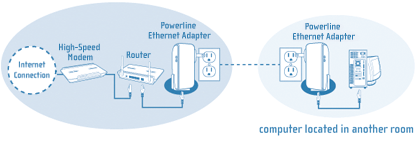

What about powerline? I read about that in MacWorld as a possible solution. ...
Never used powerline, but it looks pricey
http://catalog.belkin.com/IWCatSectionView.process?Section_Id=201539
You would need 2 adapters at $100each, plus a network cable, assuming you want this kind of setup (attached image)
For $210 bucks, you could get an Airport Express and a a card for the 3rd floor computer. That would be more flexible, but less secure. Just be sure to setup WPA and such.
