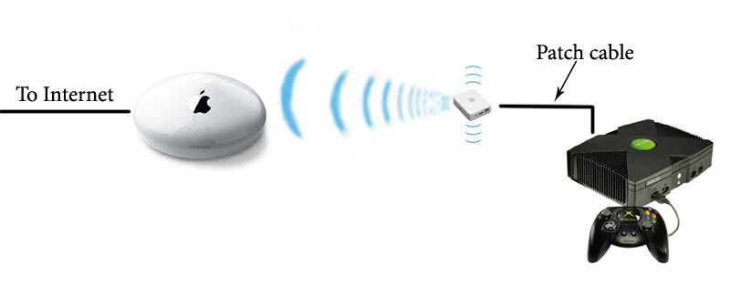

Ok, this is my analysis of the situation....
You have:
1) X-box/PS2
2) Existing Airport or other wireless router
3) Airport Express
You want to use the Airport Express as a "bridge" from your X-box/PS2 to your wireless base station and thus to the internet. (see attached image for diagram)
So if I am understanding the situation corectly and the information put forward in a previous post, then you should be able to use the Airport Express in this way.
You have:
1) X-box/PS2
3) Airport Express
Yep, that was the problem, and yes, you can use Airport Express in that way as per my previous post. I only tried connecting to my airport extreme basestation though - haven't tested it with any other wireless routers because I don't own one, so I can't guarantee it will work.
working so far...
