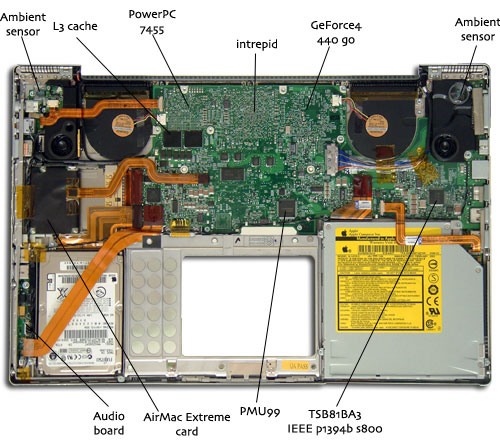

Okay, so I went in to re-mount the airport card, but I can't find it on the 17". I looked around and the only really good guide for doing it is on the 15". I think that maybe because the 17" comes with it on all models that it's harder to get to... what should I do? I searched this forum and googled for a bit but no guide that I Could find on how to do it for a 17".. any suggestions?
EDIT: So.. after doing a few more searches (mainly just trying to figure out where the AE card is in my 17") .. I have decided I am not touching it with a 10 foot poll. I am perfectally comfortable working with computer hardware, but I am not comfortable with voiding my warrenty.
I don't blame you, especially if you're still under warranty, and may in the end need to exercise your coverage. I trust the photo is not of your dissected PB!
If the AirPort card was factory installed, don't worry about that one. The optional RAM should be easy to remove.
