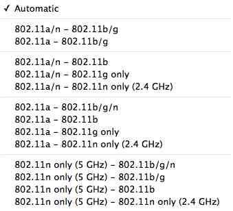

However, if you hold down the OPTION key while selecting the menu you will get quite a few more choices:
It's a lot of data already, but it’s not hard! Here’s a breakdown:
802.11(x)
For starters, an 802.11g network will slow down to accommodate an 802.11b device. The same goes for an "n" network when a “g” device or less is connected. However, the degradation of speed experienced from that is far less significant than when either of those devices are connected to an "n" network. This is where a dual band router like the current APE come in. It can have two separate signals so specific devices can be on their own band, and won’t slow down the others.
What option you set will determine your network. The outdated “a” (described below) most likely won’t slow down the “n” band, and “b/g” on the other band won’t have a huge effect on each other as described above.

That’s up to you to decide! For most people with notebooks, phones, and/or a newer desktop, I would recommend, “802.11n only (5GHz) - 802.11b/g/n". If you are within the 5GHz range, you will get the most out of your "n" device. If you travel outside of it, your device will connect to the 2.4GHz frequency. If it's the only device connected, it will still benefit from the "n" speeds, but again, that band will slow down if other "b/g" devices are connected at the same time (which otherwise won't happen on the "n" only 5GHz band of course). This setup would have both the advantages of a dual band network and disadvantages of a single band depending on your range.
If you will always have "b/g" devices connected to the 2.4GHz band (like I do) then setting it “802.11n only (5GHz) - 802.11b/g/" would be essentially the same.
If you have mixed devices, but can't afford the range loss of the 5GHz, set it to “802.11a/n - 802.11b/g". If you only have a couple devices, and not many visiting devices to your network, set it to whatever suits them best.
If there are several signals crowding your area, or if you live in a small apartment/house, or if you just want to get the most out of your "n" router then operate it in the 5GHz range. Personally, the 5GHz frequency has about half the distance of the 2.4GHz in my house, but the few times I go outside that range it automatically connects to the 2.4GHz network.

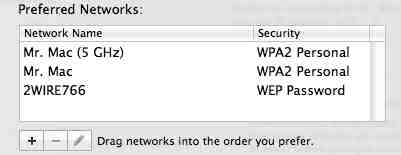

As a side note, if you want a notebook to default to this network when in the area, head into your System Preferences->Network and click the Advanced button, and just drag the preferred network to the top of the list so that if both are in range, it will connect to the 5GHz by default:
802.11(x)
