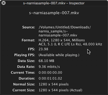

You can have a look at the codec by opening the exported file in QT Player and opening the Movie Inspector (CMD+I).
The codec can be found under Format:.
Can you post a screenshot of that Movie Inspector window please?

Here's the Inspector window, which indicates the codecs used.

QuickTime Video Settings
Compressor: H.264
Quality: 100%

I'm a bit baffled, why the sequence settings use the H264 codec, as that is a codec not meant for editing.
It should either be AIC (Apple Intermediate Codec) or ProRes.
