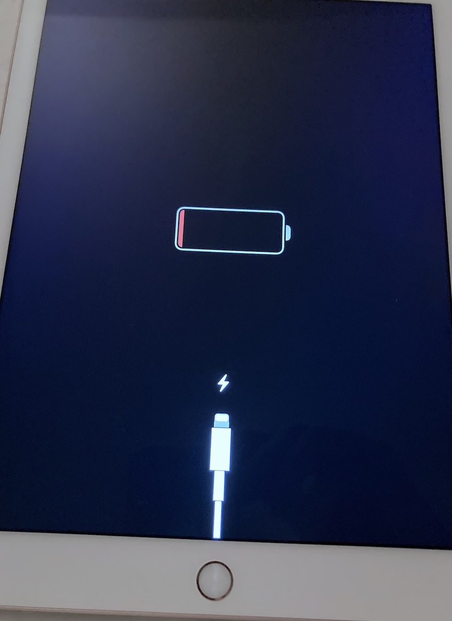

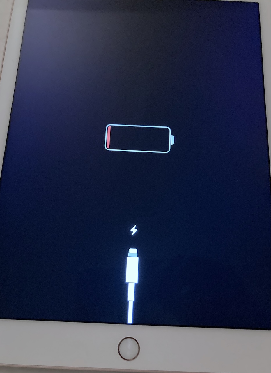

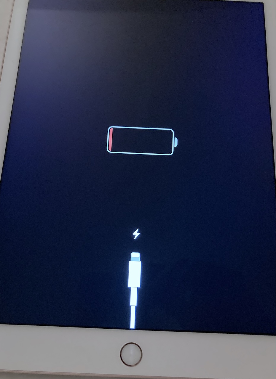

It's not the battery, the boot loops happen even if it is not connected to anything but now that it is completely empty it seems, it can't be charged anymore.
I haven't used it for a few years and the battery was like new when I started using it again.
Now it's empty and I see the "connect to power" image the first time again after the boot loops happened. I think it got empty because the Mac was sleeping and not charging anymore while it was still booting over and over again.
But it seems to stay too long in that empty battery state now and I will connect it to a MacBookPro Charger, just to test, if it can be charged again.

This is all I get now for a few seconds, after pressing the power button. No difference if connected to power short, long or not at all. At least the boot loops are gone. 😉

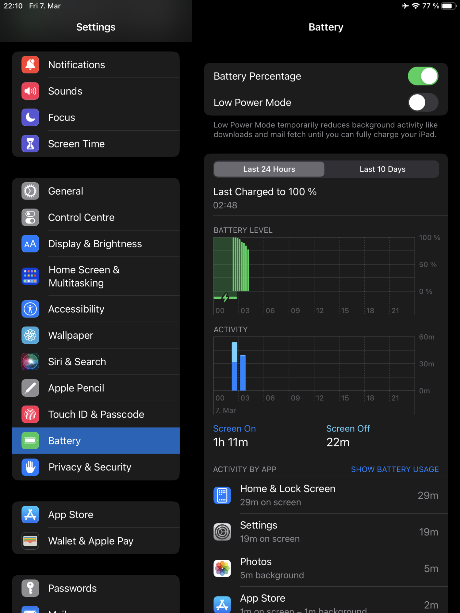

Don't iPads show Battery heath? I only see this:

Battery health came in earlier on iPhones than iPads, and is limited to the iPads released in May 2024 and later.
Older iPads can use the method described here, if the analytics option is available on its OS: https://www.tomsguide.com/how-to/how-to-check-your-ipads-battery-health
