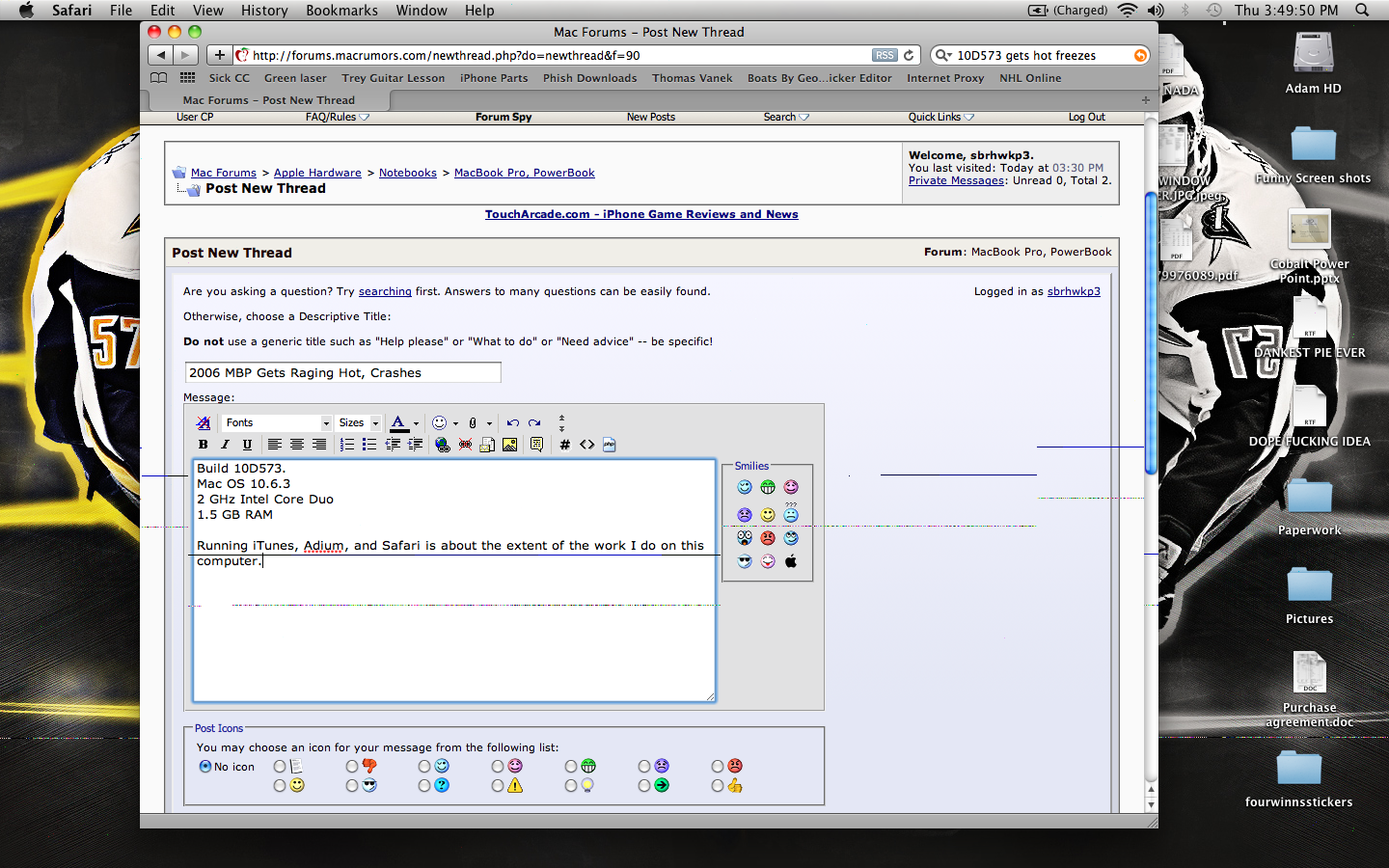

Build 10D573.
Mac OS 10.6.3
2 GHz Intel Core Duo
1.5 GB RAM
Running iTunes, Adium, and Safari is about the extent of the work I do on this computer.
Yet it consistently runs ridiculously hot and crashes. I also get weird lines through the screen, as you can see in the attached screen shot.
It doesn't run slow. It's actually very snappy. I regularly use onyx, I've upgraded the RAM from the weak standard of 512 MB, and I even swapped the original 80 GB hard drive to a 320 GB drive.
Can anyone give me any insight on what I can do to prevent this from happening?

Lines look like a cooling issue.
Possible open it up and blow some dust out with compressed air?

It is a somewhat failing video card. ATi video cards tend to show artifacts when its heated up way too much. If I were you, I would clean the dust out of the system. Take the top lid off, here's an iFixit link. It's not hard at all, and use compressed air cans and clean out the fans and heatsink. If you're savvy enough, you can remove the fans to get the large dust pieces caught in between the fans and heatsink.
http://www.ifixit.com/Guide/Repair/...-Model-A1150-Upper-Case-Replacement/483/1#top
Run the hardware test on it (included with the system CD's).
Alternatively, you could check the fans only by downloading SMC fan control and monitor the speed of the left and right fans.
This will probably help you out a lot! Your laptop is now moving towards the 4 year mark and even without being in a dusty environment there tends to be a lot of dust build up over time. In a 2006 MB of a friend of mine I recently removed what seems like a vilt carpet between the fan and heatsink. This cooled it down a lot (10 - 25 degrees celcius) and stopped all the freezes and glitches.
I did the same for my 2007 MBP, not as much dust but still noticably cooler and above all more silent, a big recommendation for laptops of this age.
Use the correct tools and keep your cool and the iFixit site will guide you through it fairly easily!
