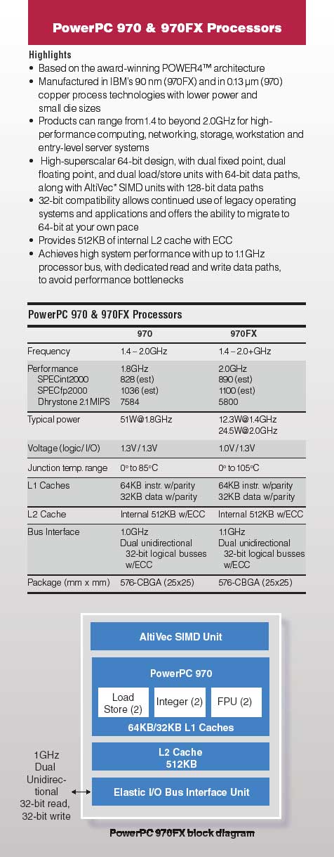

Funny, I see no differences in cache size. The other site messed their pants with this one.
attachment.php
i can't find any thermal data on the 970fx. for future reference, here are some apple numbers on heat output of the 130s.
