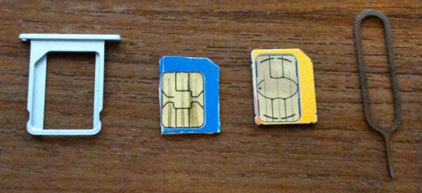

Can you post a pic of the modified BSNL 3G sim along with the AT&T one that comes with the IPAD? I'm getting my Ipad 64GB/3G next week from the U.S. and want to make sure that I don't make a mistake when I chop up my BSNL 3G sim to fit the Ipad.

Sorry I don't think it's possible to upload to Macrumors and I don't use twipic or any of those hosting sites, but I did slam it up on my FB page, here's a link. The key, imho, to getting it right is to basically get the corner near the chip that's opposite from the cut-out corner, get that as close as possible and the rest will work itself out. The chips (on the sims) are actually different shapes, so I had to guess at which parts I should make match, but I looked at where the AT&T chip showed through the tray and then cut and trimmed until the BSNL sim basically matched that (and barely fit into the tray).
One a side note, after taking it out and putting it back in, I had trouble getting it to read the BSNL sim, but when it finally did the network popped up as CellOne and I thought I'd have trouble again, since the 3G had only showed up on 'BSNL' network, but after I turned off wifi I got the 3G logo on the CellOne network as well. No idea why it shows up as CellOne sometimes and BSNL other times, but 3G was the same.
The picture is much appreciated. Thanks!

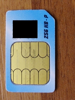

OK, it looks like I have a different contact design to yours. The contacts on my phone have slid over the left three columns and the fourth column on the right is superfluous. So, I would still use the bottom left corner (diagonally opposite the notch) as the reference like you did, right?
Yes start from the bottom left and cut from there. Good luck - and thanks for attaching the photo for me :)
