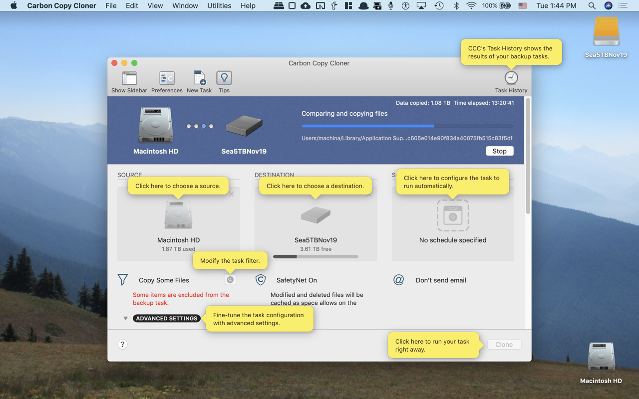

Last night at midnight-ish I started backing up my almost nearly full 2TB 2016 15" MBP to transfer it to the new 16" 4TB.
I read in other threads very positive comments about Carbon Copy Cloner when transferring machines. Am taking the final backup with that. I have Time Machine backups too.
I haven't decided which to use for the transfer of user data to new MBP, Time Machine or Carbon Copy Cloner. I do want to reinstall my apps instead of transfer all my old ones. Want to get rid of the flotsam and jetsam and incompatible apps.
2 questions:
1) Is 81 GB / hour a good backup speed?

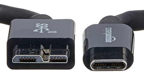

I'm using a Seagate 5TB Backup Plus external hard drive plugged into my laptop with a USB-C to disk drive cable like this one.
1.08 TB of data copied in 13 hours, 20 min or 13.33 hrs.
= 1080 GB of data copied per 13.33 hours
= 1080 GB / 13.33 hours
= 81 GB / hour

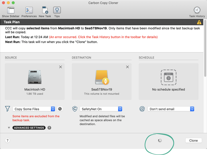

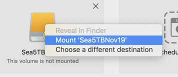

Now, the Seagate drive won't make itself visible in Finder.
I've power cycled...
When I try to Mount it, I only see the spinning vortex.
Update:
I fixed the problem of the drive being invisible by:
- rebooting a couple times
- switching USB-C ports its plugged into
- running the Disk Utility app and making it scan for all drives (trying to remember what I clicked on to make it re-sniff...)

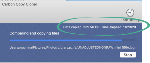

But OMG now it's even slower
339.56 GB copied in 11.38 hours
30 GB / hour
or
50 MB / minute
Odd. My source drive is 1.8 TB full. My backup drive now has 2.11 TB of data.
I haven't created that much new data since I started backing it up...
