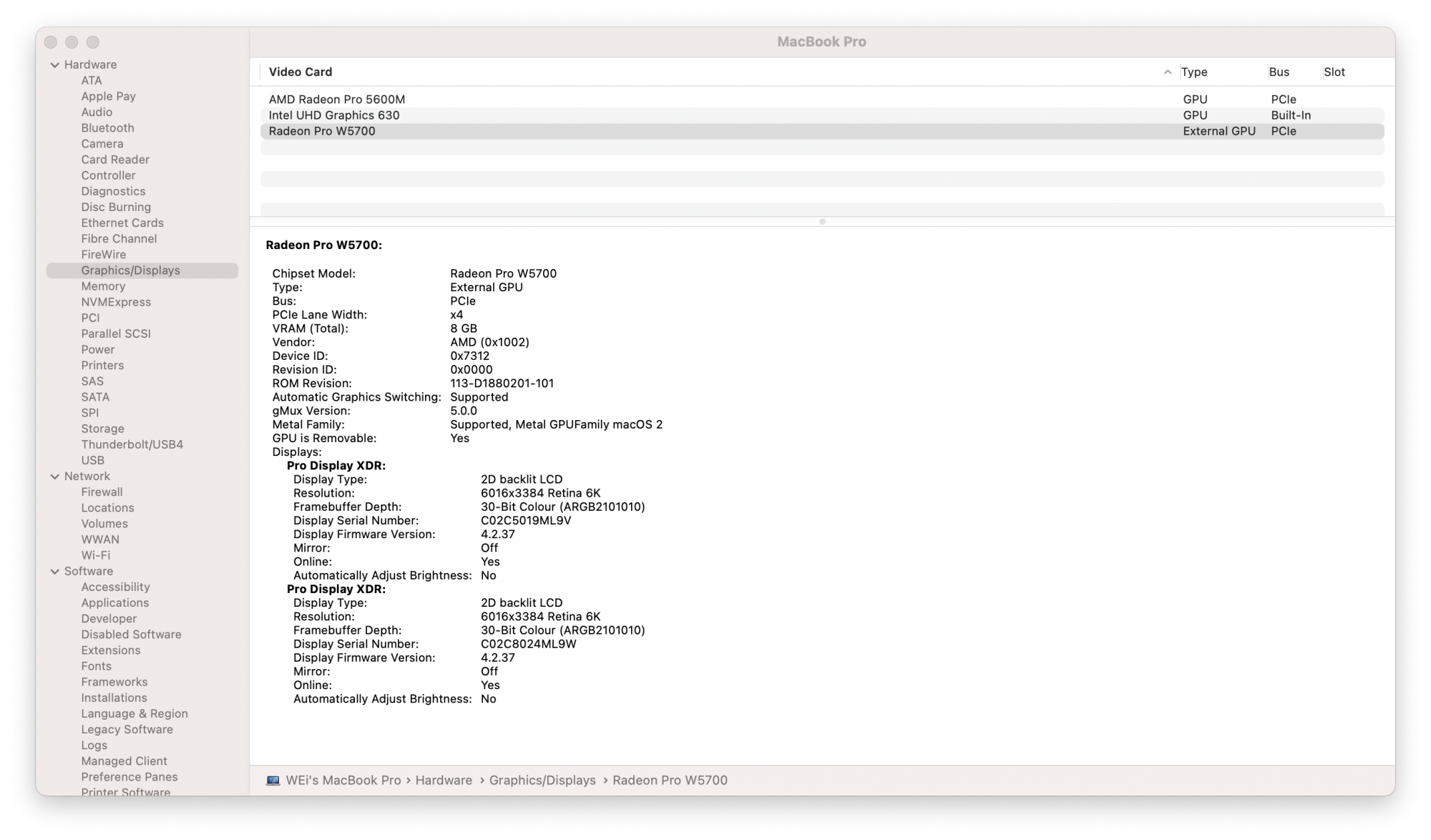

My setup of eGPU + Pro Display XDR x 2 works on Big Sur 11.3.1 perfectly, finally.
eGPU is Razer Core X Chroma + Radeon Pro W5700.
One of the XDRs connects to the USB-C port of W5700, and the other connects to a single DisplayPort of W5700 with Belkin VR cable.
Both of the XDRs work on 6K resolution and 60Hz. Preference mode enabled, and brightness can be adjusted on Touch Bar.
My Pro Display XDRs are both on the latest update. The firmware version is 4.2.37
