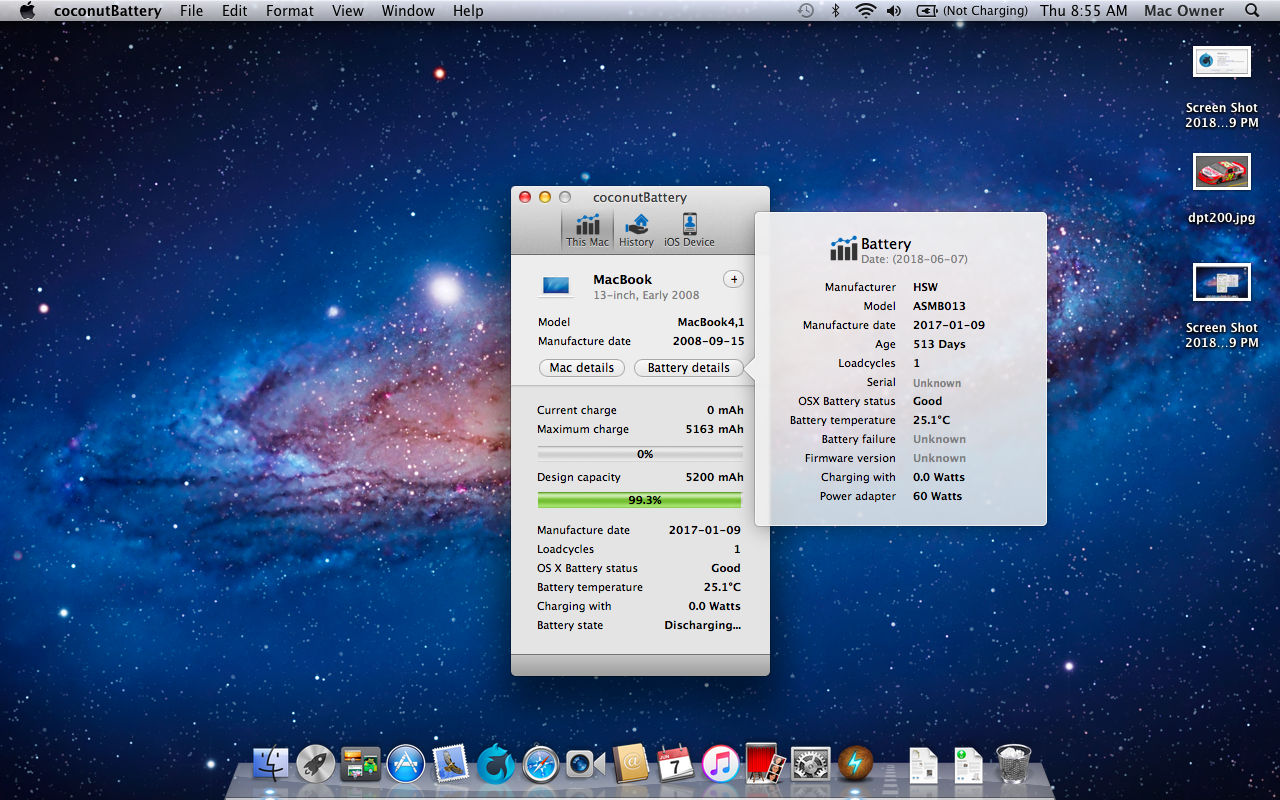

Obviously, this isn't a PowerPC, but it seems like the folks in this section of the forum are also quite knowledgeable on early Intel stuff, so figured I'd ask here. I have an Early 2008 white Macbook which will not charge. The battery status is always "Not Charging" both with the original (OEM) battery and a new (Chinese) battery I bought from Amazon. I have attached CoconutBattery screenshots for each. Interestingly, both report their "Serial" and "Battery Failure" status as unknown. Might that be a clue? Thanks for the assistance!
EDIT: I forgot to mention I did already try an SMC reset. I also just reinstalled the previously missing AHT through a link found on the garden. The basic test didn't find any issues, so I'm running the extended test now.
New Battery:
Original Battery:

Just wanted to update this thread to let everyone know the resolution, and in case someone runs into this in the future.
When the new Magsafe board and battery connector came in, I installed them, only to get the same behavior out of the old OEM battery. I had already returned the new aftermarket battery to Amazon so couldn't test that one.
So, I ended up ordering another (even cheaper :D) aftermarket battery from Amazon, and it worked with no issue. :)
The only way to tell if I actually needed either of the internal components would be to open it back up and stick the old ones back in with the known-working battery, and that ain't happening. ;) They'll have to chill in my parts drawer until I have another flaky A1181 lying around to mess with.
