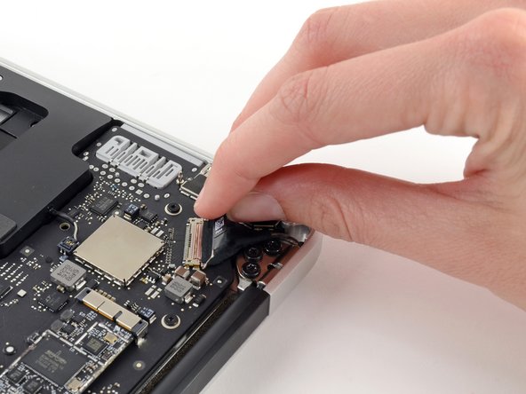

You can try reseating the display data cable connector.
Remove the bottom cover. Find the display connector.
It looks like this:
Pull the plastic tab on the display data cable connector to unlock it.
There's a little spring clip with a plastic tab. Pull that to unlock the connector, then slide the connector out of its socket. (Don't' pull up on the connector), then re-insert. Push the clip back in place. Look around that area for evidence of liquid, or obvious corrosion (often a green-ish or blue powder near any of the chips) The reseat might help, or may do nothing at all, but worth a quick try.
It looks like this:
Before doing this disconnect your battery first.
