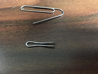

First things first, I need to remove the pins from the 6 pin connector (luckily they left one of the 6 pin connectors off). So I made some tools.
Rudimentary as they may be, they did work. So lets start running some cables!

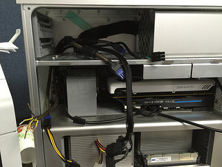

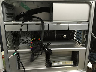

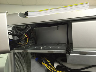

Beautiful, cables routed with no cutting of the case! Now lets run the power.
That won't fit through the small cable route.

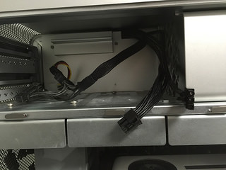

Alright, end of the power cable removed and routed through the same spot as the PCI cables. The observant of you will notice the error of my ways though...
Measure twice cut thrice! That power cable won't fit through the empty PCI slot! So I get to pull the cable and run it up the case again, as is life.

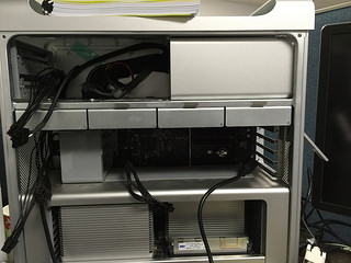

Alright, everything routed...backplate reinstalled....lets power this beast up.
And click.....nothing
Try as I might, cursing at it didn't fix the issue. In fact something was very wrong, power button did absolutely nothing. Unplugging the power and trying again resulted in the same thing, a single click and then nada.
Turns out the little power supply cannot handle the 8-pin power being split, damn custom cable. Anyone who has seen the cables that come with the Juicebox knows they are beasts. After having waited 2 weeks to get these cables I was out of patience.

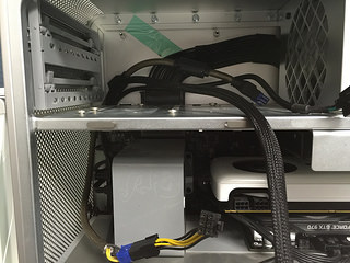

That is one of the two cables pushed through the small area precut for cables. Still no case mods. But the second cable wasn't going to fit without a fight.
I thought I had won't the battle...

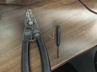

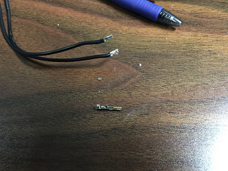

At this point I have gone into a slight fit of rage, not only did I have no parts but my tools for this entire venture were these:
A pair of pliers I found on the side of the road (literally), my extraction tool and a small flat head screwdriver. Clearly prepared, I did what any man would do.

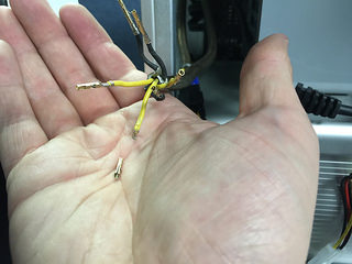

I CAREFULLY disassembled a pin from my custom cable. It was useful after all. Then installed it on the wire with the broken pin and was back in business.

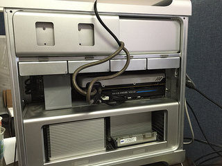

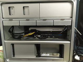

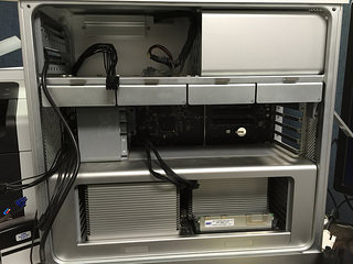

Almost finished, the cables wouldn't reach with the back plate in so I ended up having to leave it out, plus I couldn't slide the DVD tray in all the way due to the HUGE ferrite cores on each cable, plus the massive girth of the cables themselves.
Fired it up and all is well, no case mods and I even managed to use the cables provided with the aux PSU. Both Dell P2715Q 4K displays are humming away at 60Hz. Hope you all enjoyed my little adventure.
