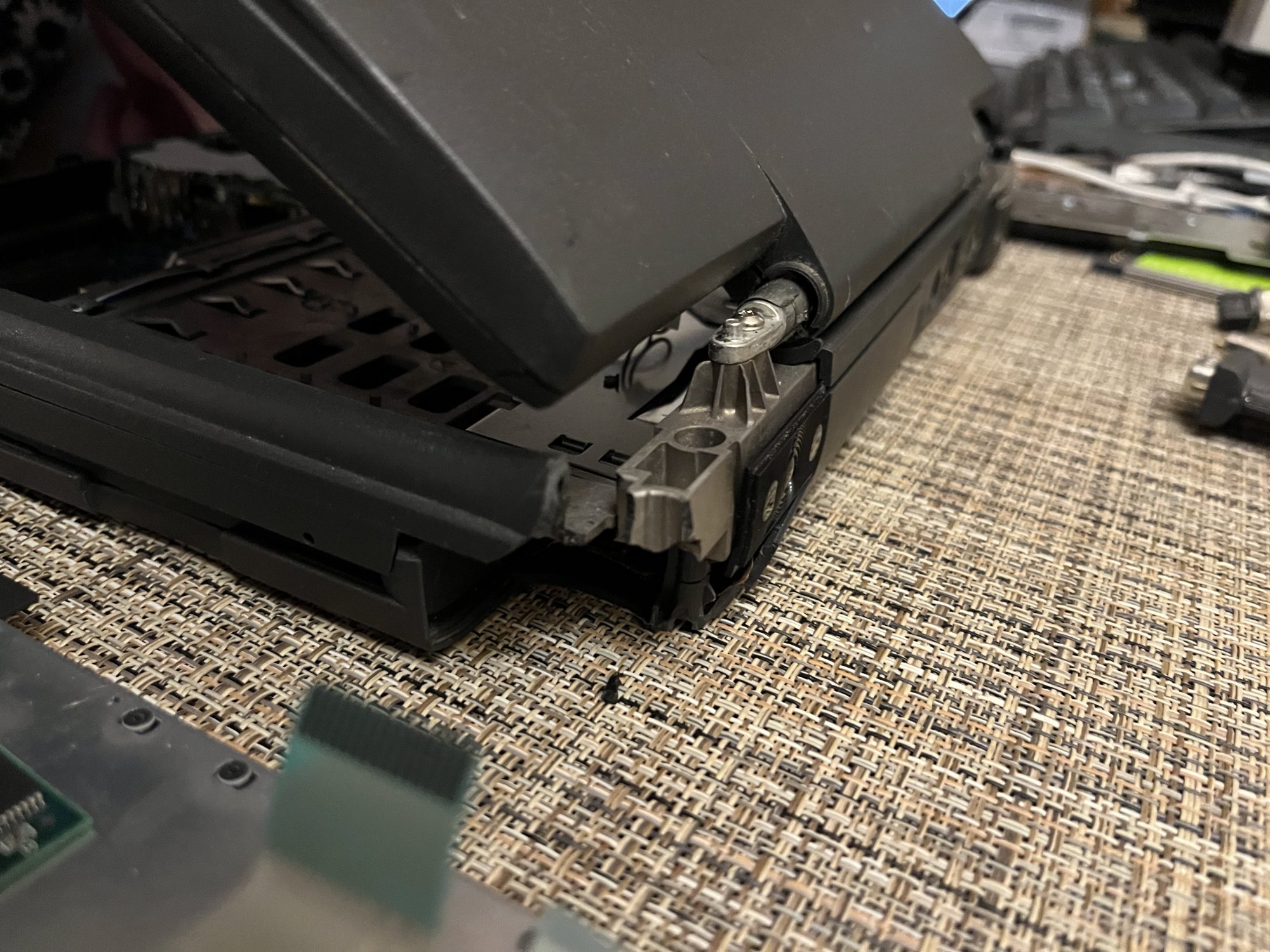

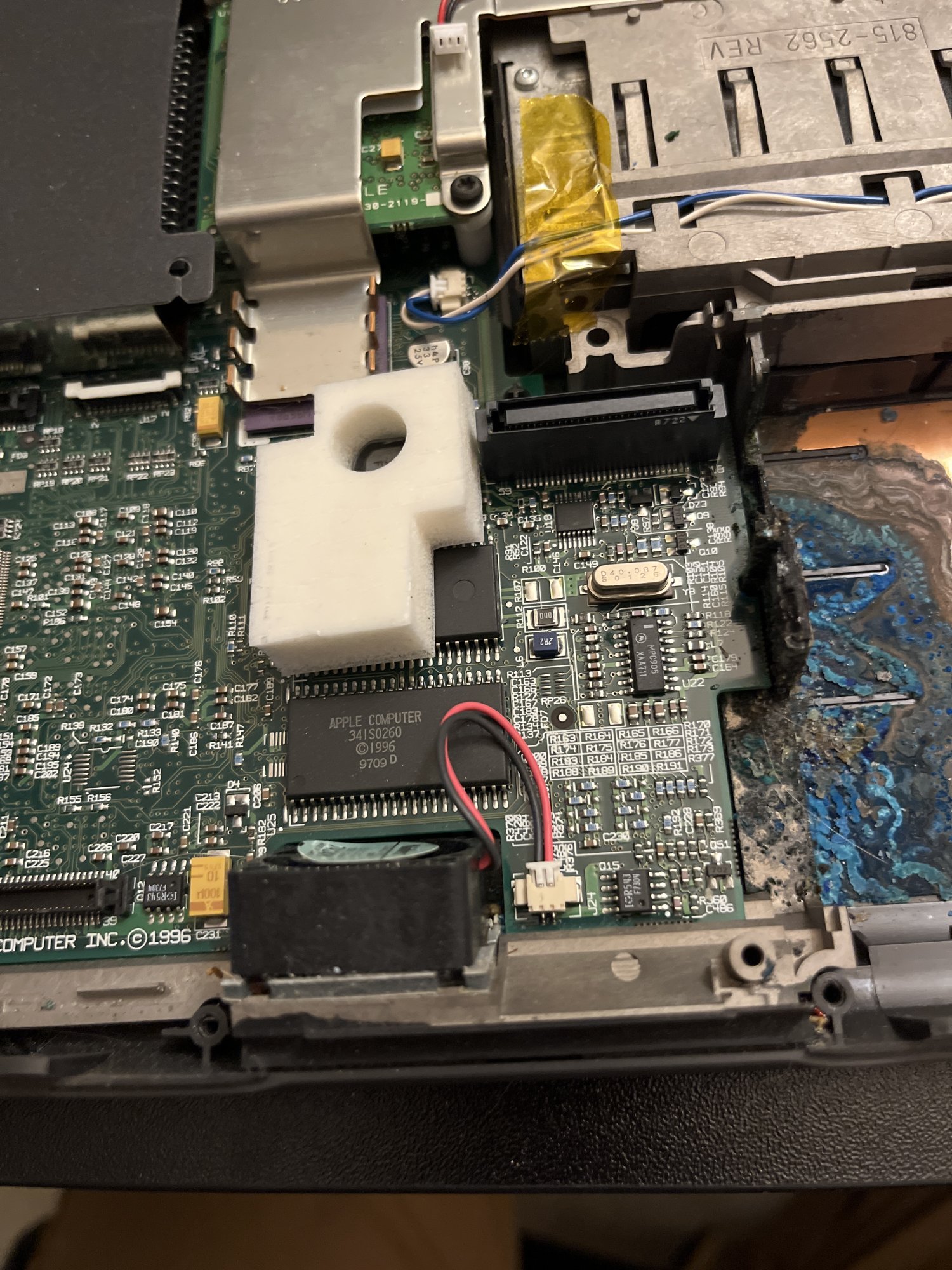

Here’s the right corner which was destroyed in shipping.

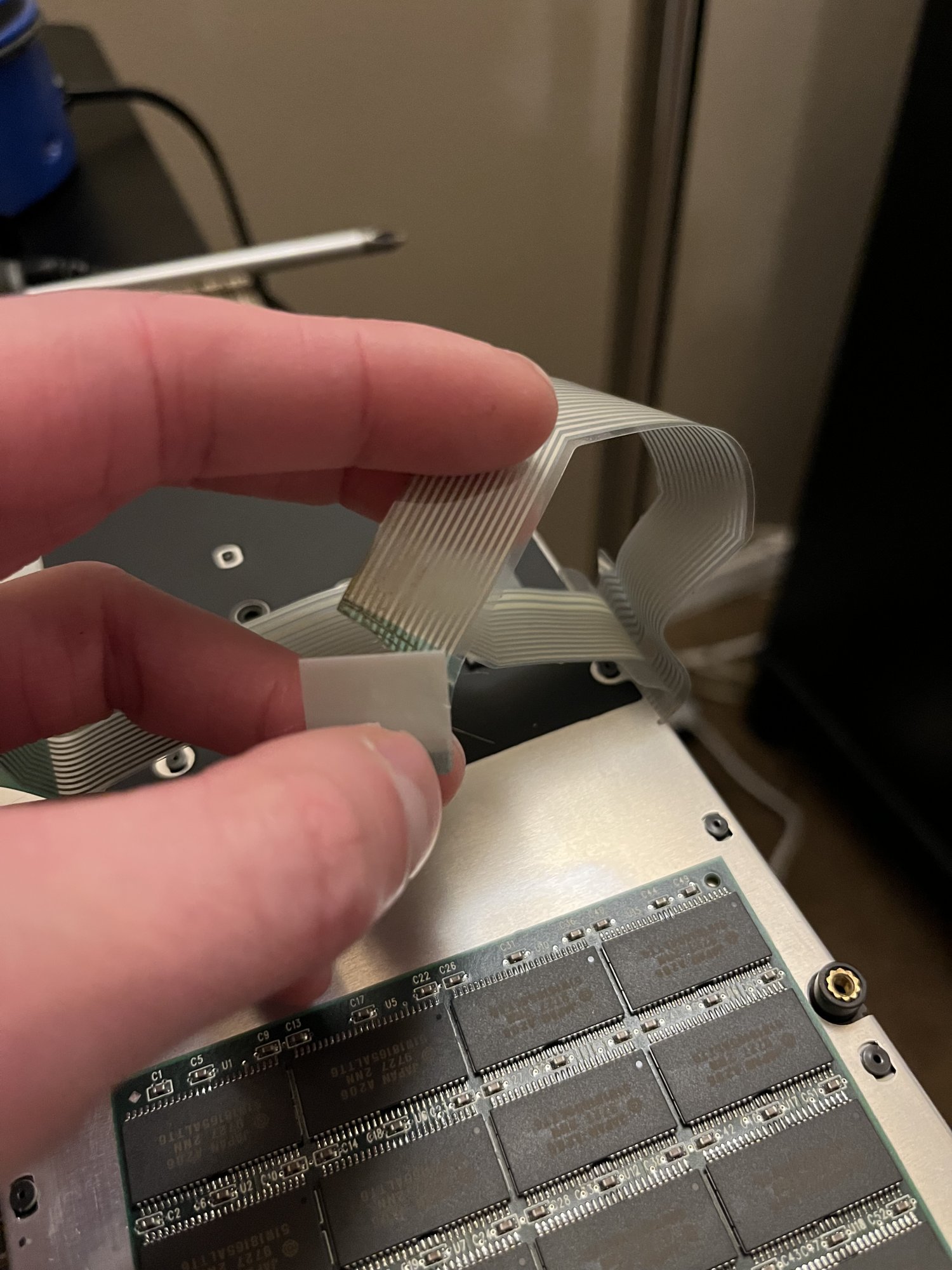

I pulled it apart to get the HDD out and found a couple other issues. Firstly, the keyboard. IMG_8326.jpegIt would power on (and it did actually chime I’m not sure why I thought it didn’t) when I would plug the power in. But from there the only thing that would happen is I would hear the hard disk spinning up and down. This ribbon cable on the keyboard was broken, and I’m positive it was like that before I took it out. I was hardly pulling on it and I noticed it was ripped. So that could explain partially of why pressing the power button didn’t seem to do anything.

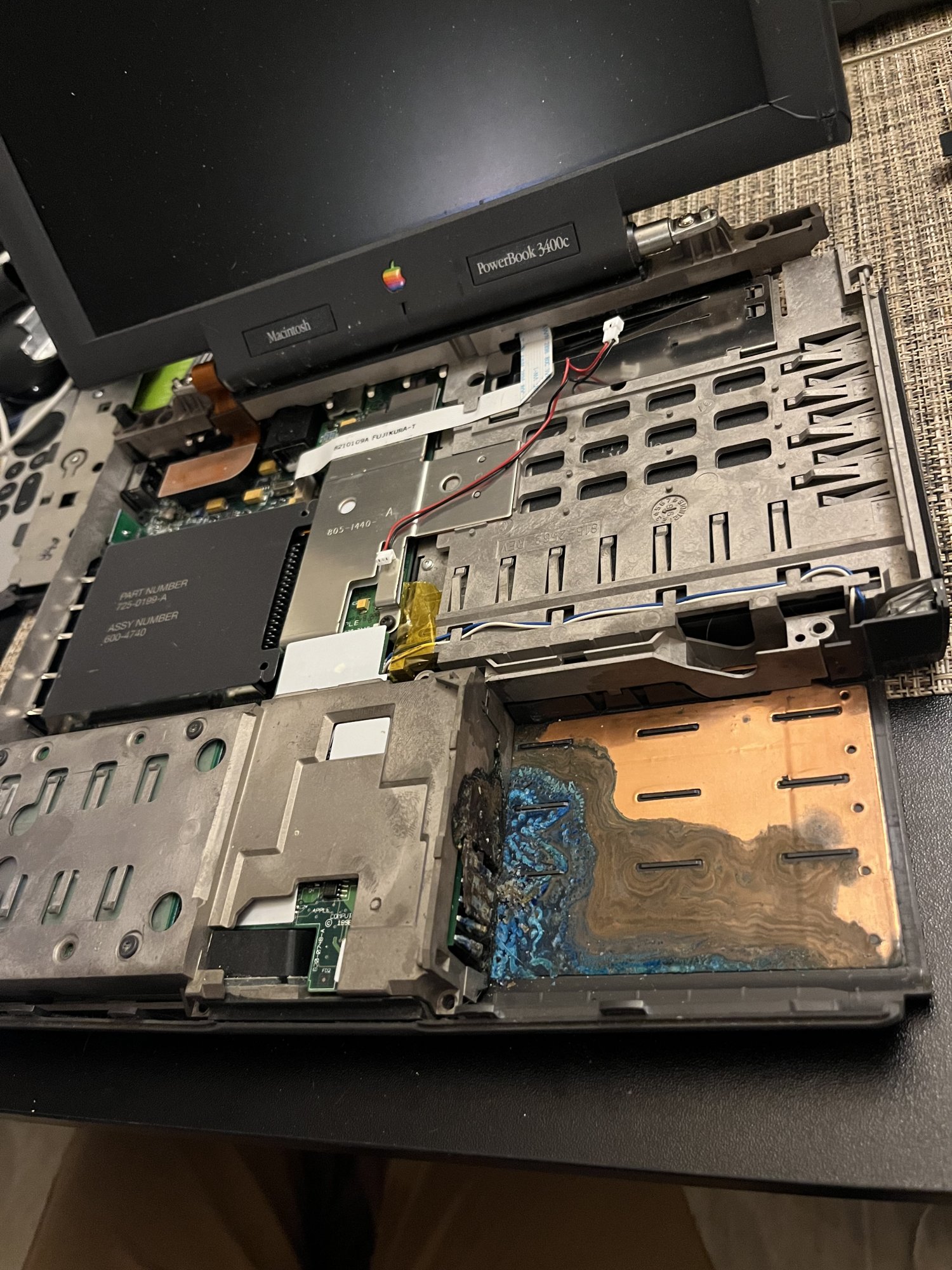

As you can see the battery full on exploded. And it’s hard to see in this picture but there appears to be some slight corrosion around the keyboard ribbon cables as well. So one of these days I’ll get around to pulling the entire board out.

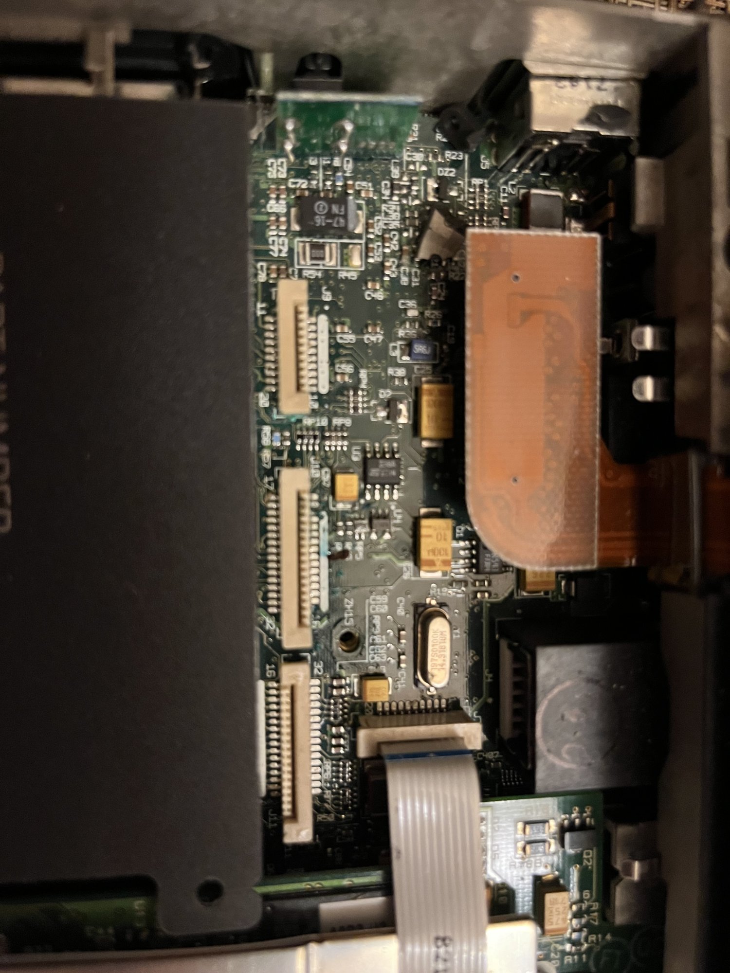

image.jpgThe board looks pretty okay other than that. But I’ll still be taking it out, and especially examining the bottom. The power board even looks okay besides the connector.

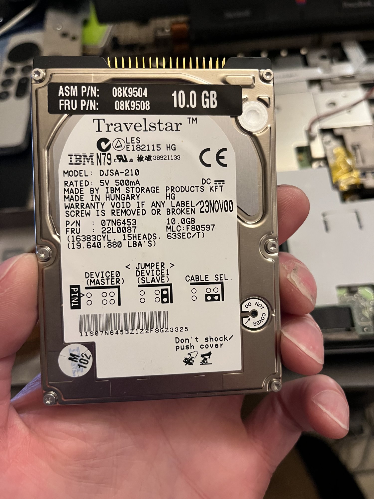

I did get the HDD out, and it’s clearly not the original. Actually bigger than the one that was in the Lombard.IMG_8327.jpeg

Also just a little update. I can't seem to figure out what is on that drive at all! From what I can gather, it's formatted using "Apple UFS Server". So far no version of OS X I've plugged it into knows what to do with it. I'm going to try using 10.0 - 10.2 on my next days off to see if they will since they still included more UFS support. I have a feeling if the partitions on this thing are readable at all, it's something weird like PPC Rhapsody or a very early OS X preview.
I don't know if its bootable at all, I stuck it inside my 1GHz TiBook which won't boot anything earlier than 10.2. I then put it back into a FW enclosure to screw with it on my Pismo since it'll boot older versions. The boot picker on the Pismo hung for like 10 min with it plugged in, so if it is bootable, it might not be over FW.
This definitely reeks of a Rhapsody disk.
There is a specific Startup Disk control panel on the Mac OS X Server install medium that may help identify what it is-- the regular one that ships with classic Mac OS has no idea. That said, I can confirm that 10.1 can at least detect a Rhapsody disk. Unsure if it'll actually mount and be useable though.
Have you tried a Linux box?
Not sure about Apple_Rhapsody_UFS volumes but Jaguar can use and boot from Apple_UFS volumes created in its Disk Utility.

While I had it in my TiBook I booted that up from a Debian 16.04 Live DVD, it ended up freezing when trying to do anything once the desktop loaded. Then I booted a FreeBSD live DVD. I didn't attempt mounting it but I was able to view what it said the partitions were. If I don't have success with Jaguar I'll figure out a way to hook it up to my FreeBSD desktop box.
I fired up Puma on Belfast and the disk I dedicated for OS X Server 1.2, formatted as Apple_Rhapsody_UFS, showed up and is readable, including the root volume being browseable in Finder.
Should work on Jag as well but Belfast is a Rev 1 Beige and Jag panicks at the sight of the onboard graphics chip, thus I can't check that.

So Jaguar doesn't know what to do with it either. I got kinda busy the past couple days I had off, so I didn't screw with it much beyond that. And I ended up running into issues on my Pismo anyway. I am trying to install Mac OS X Server 1.2v3, but it won't recognize any drive (and drive setup freezes up). I do have a Mystic G4 which is officially supported, but nothing shows up there either, I'm thinking the Sata card I have in that is screwing with it. I put in a HDD on the IDE bus (It's usually empty, I only use SATA on that Mac). The OS 9.0.4 that the installer boots to seems to be pretty finicky. It won't show my SATA install of Leopard in start up disk either.

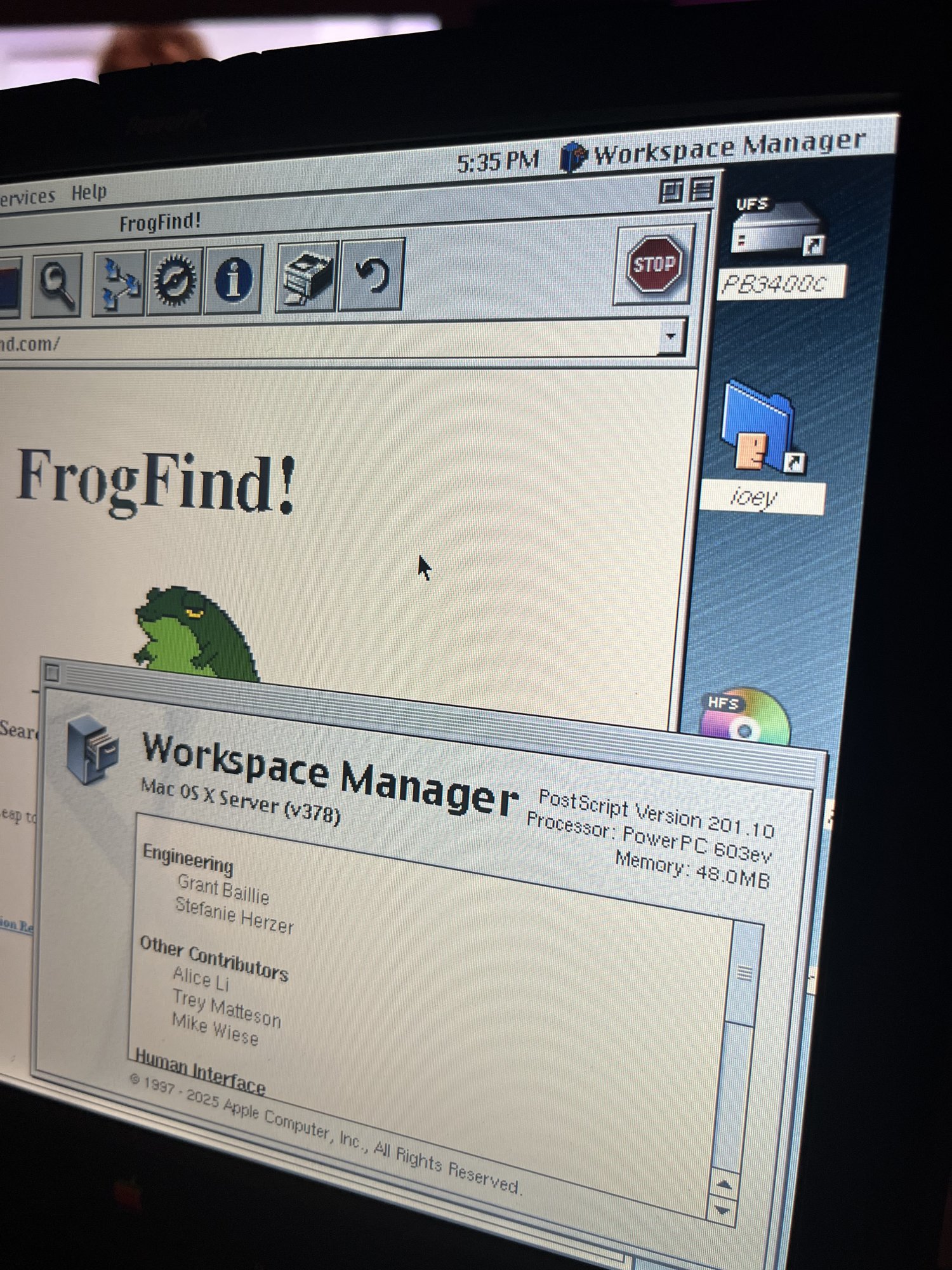

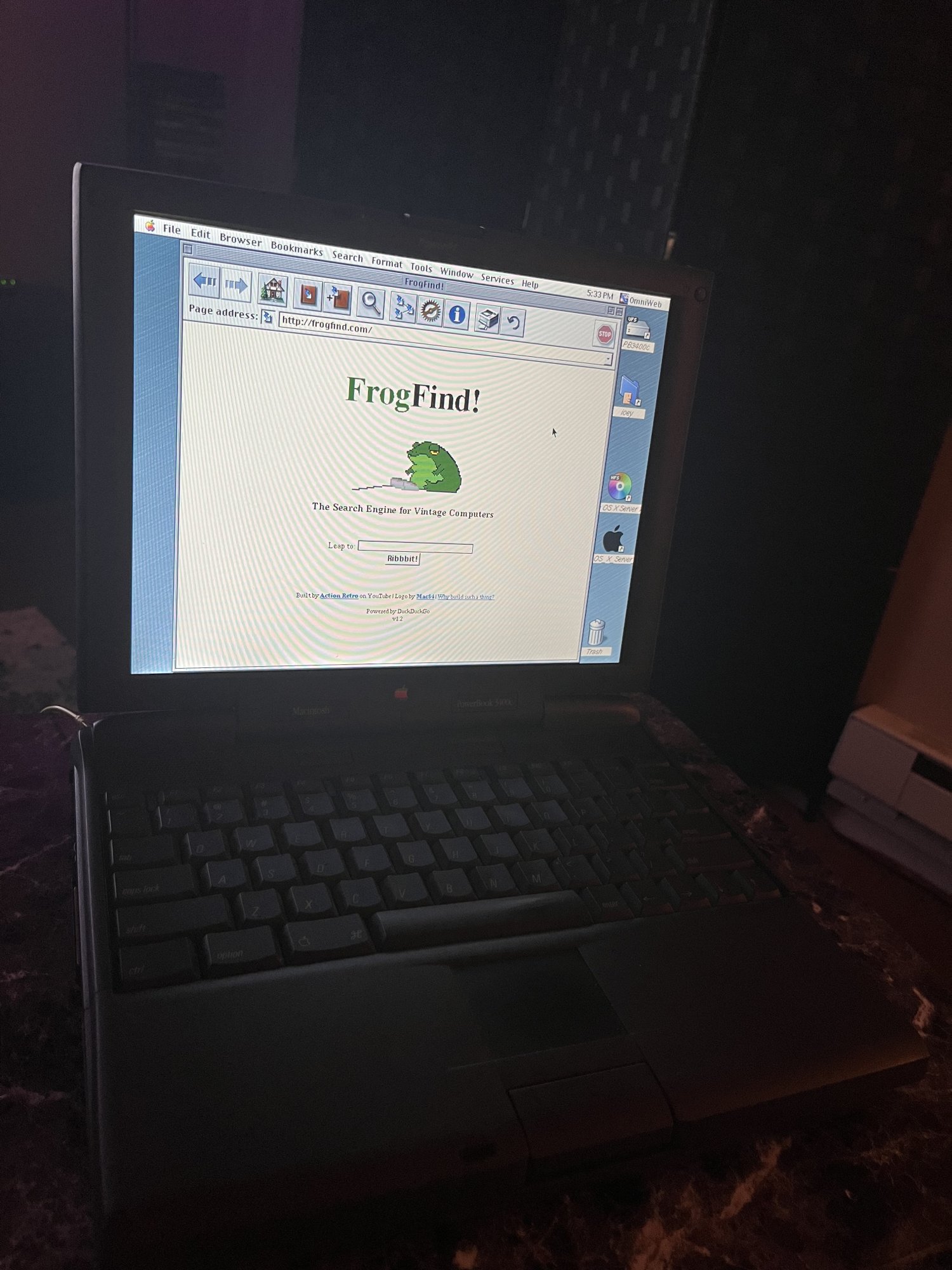

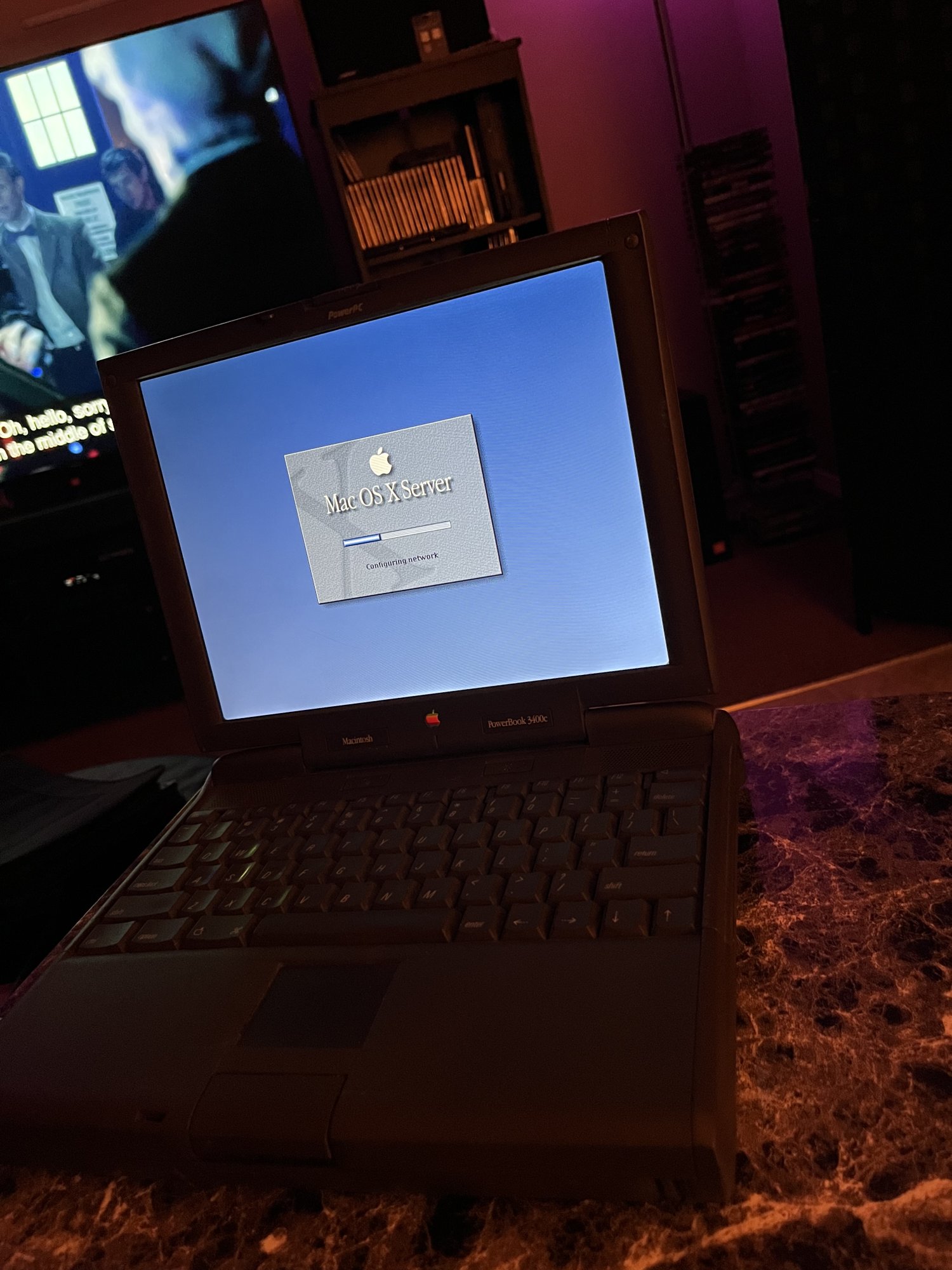

I decided to install Rhapsody instead. I don’t think I’ve ever ran it on real Apple hardware before. A little slow but otherwise it seems to run fine.
I need to put a bigger faster HDD in here. I’ll get around to it one of these days.IMG_8593.jpeg
I got it online too. Turns out it doesn’t have DHCP? I just set an IP address manually and everything seems to be working. IMG_8597.jpegIMG_8598.jpeg
