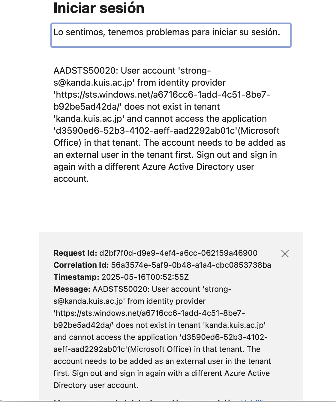

I recently updated to 15.5. After which my MS 365 account was inaccessible. My username (uni email) was not recognised as valid despite being in the system (and previously worked). Worked with tech team for days. Deleted all account info. Re-configured, no access. They suspect a problem in the keychain but cant't repair. Their only solution was to partition the HD and make a new user account and instally MS 365 again there. It worked! But now I would need to reconfigure everything from factory mode, manually copy file folders and probably lose photos in i-photos, and other apps. Noone understands why I can't sign into the MS365 account in my current user account and why I can do this in the new user account created.
I had thought I could use time machine to go back to previous OS and see if everything worked as before. I was told it couldn't be done. No going back after OS update. Curiously, my Mendely reference manager also had a shock. Suddenly, all (hundreds of reference) were missing and only a handful were left, all of which I am author or co-author. All the rest were missing/deleted. No idea if these two things are connected, but colleagues told me others had had issues with the upgrade. Anyone know of a way I might be able to "fix" this problem and be able to sign into my MS356 account where the username is recognised? It's in the univeristy system and is a valid 365 account - the proof being that in the newly partioned user account on my macbook air it could be installed and I could sign in! I want to keep my current account and use MS for mac there, not in the new account and have to reinstall all of my documents, apps etc.

Hello and thanks to everyone who has kindly responded. What the tech support people and I did was to run a programme MS office for mac license removal tool 2.7 installer. That was done again at different times. They know that there is an account in my name in the university system but even when they set a new temporary password when trying to log in an error message would show up that said my email didn't exisit in the system (screen shot of this attached). We tried this many times. Finally, they decided the only option was to create a new user account on my mac and download/install 365 there and see if it works with my email and a temporary password - and it does! But as I said I'm not too thrilled about having to manually migrate all my files and apps to this new user account. They strongly suspect at keychain issue but can't figure out what that might be.

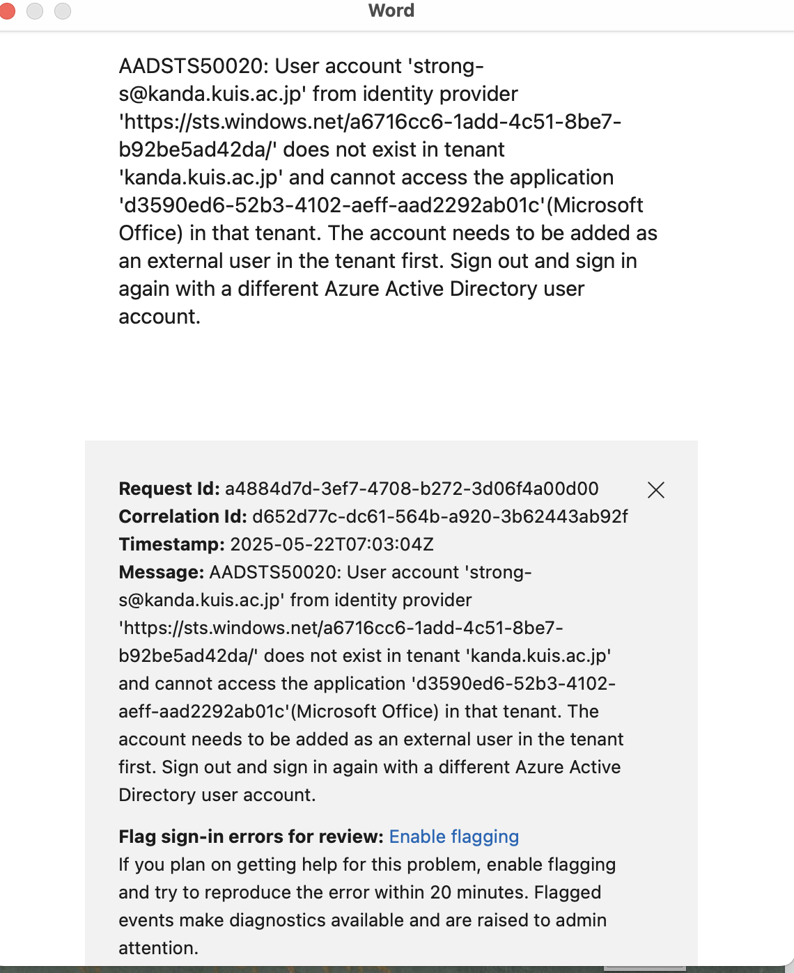

I've been told by the tech staff at my university that the only way to keep using MS 365 in my current account (not the new one) would be to re-set the keychain but that "this action will delete all password information saved on your PC. This includes your login information for your user account, Wi-Fi password, and passwords for other apps." So, I don't know if that would be a smart thing to do.
You had asked me: Have you deleted the Microsoft entries in Keychain Access so that they can be rebuilt? I don't know what they did but if you are referring to deleting it all, no that hasn't been done and as I mentioned above, I'm not sure it would be a good idea (if afterwards I can't even log in). I took your advice and downloaded the apps through the apple store but that had no effect on the problem. I got a new password from the admin people and tried to log in. I was promted to make a new password and after I did got the same error message we have been getting all along. Error message attached. I looked into my keychain just now and the only entries besides yesterday when I tried again (above) there is one from 16th May - should I delete that?

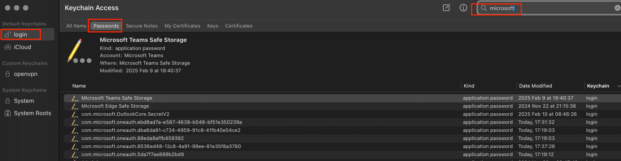

This is a bit convoluted but it is possible to clean up the keychain on old account. It is just a bit of "manual labour". This search inside the Keychain Access might be a good starting point. If you use iCloud keychain then Microsoft's entries might be there as well...
