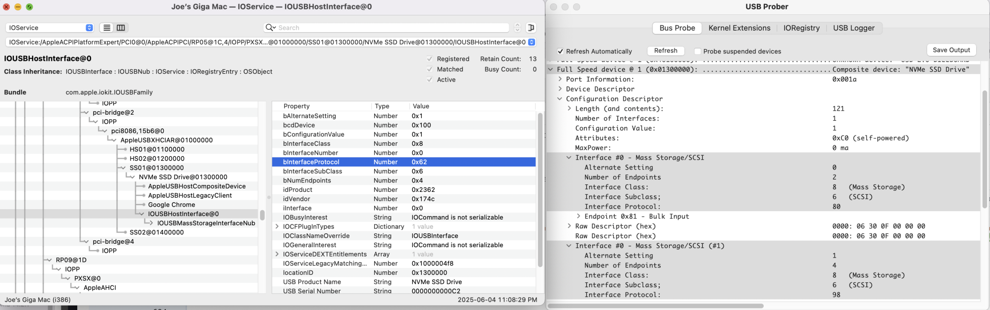

The third connected by USB uses a USB mass storage device class interface to communicate with a USB to SATA bridge.
It might use Bulk Only Transport (BOT) protocol but USB attached SCSI (UAS) is preferable (bInterfaceProtocol 0x62 in ioreg)
https://usb-ids.gowdy.us/read/UC/08/06
You have to use "USB Prober.app" to see what interfaces a USB device supports (98/0x62 = UAS, 80/0x50 = BOT)
