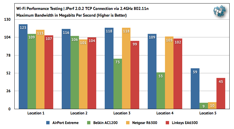

[doublepost=1527254615][/doublepost]A quick search and on this website I found the following photo:
This compares the difference between AirPort Extreme models. The model you have is not listed, but is older than the slowest AirPort that is in the test. So, your speeds would probably have been even less if it was tested.
Now you can see why there is such a big difference between your AirPort and the much newer ISP's modem.
