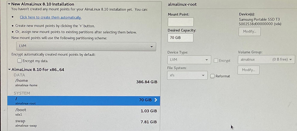

Am trying to install AlmaLinux on a Mac for an environment that's similar to a server that I lease. Was able to install it (after a few tries) on Parallels on my 2018 Mini. It works well and might be all I really need. But I thought it would be nice to install it to boot on an old Mini. So, I used rufus (in a Windows VM) to create a USB installer and after a few mishaps was able to boot my 2012 2.6 ghz i7 quad-core/16gb/256gb from it.
The installer runs fine, but I hit a roadblock when choosing a disk. I want to use an old Samsung T3 500gb USB ssd but was unsure how to format it. Tried both exFAT and FAT (formatting with disk utility on MacOS) but both of them show only 1gb of free space to the installer, even though the disk is empty. After a lot of screwing around (which I really didn't understand 🤣 ) was able to create the needed partitions using the installer and completed the full installation.
You can probably guess what came next... the Mini doesn't see that external disk as bootable and the finder just gives an error that it's an unknown format. Here's a screenshot of what the installer created, but I'm over my head here....

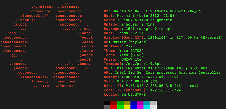

Gave up and re-installed ubuntu, which boots properly from the 2012 Mini internal SSD. The desktop version is missing some important things (like apache2, sshd...) but was pretty easy to install them, so I'll just see how I like it. The ubuntu GUI is nice, but not too interested in that, will be using this as a server and connecting with ssh on my LAN. This is what I ended up with.... interesting that it seems to think my 2012 Mini has 8 cores instead of 4 and also has the speed wrong. :)

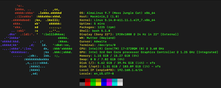

And today is another day! It just bothered me that I couldn't get it working before. Ubuntu seems fine - and dead easy to install, if any other 2012 Mini owners are looking for a Linux version. But the whole idea was to create something that closely mirrors my leased server, so I can transition away from using MAMP for local development and testing.
So, I used the installation tutorial in the link I posted above. First try booted directly into grub instead of starting Linux. Wasted a good deal of time troubleshooting but finally bailed. For the second try, I used almalinux 9, which is the same version the author of the tutorial used (I used version 8 previously). This finally worked! 😃
